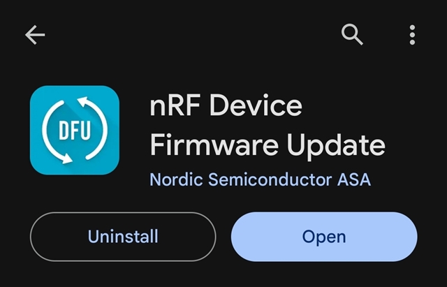

    The app that I am using is as you specified: nRF Device Firmware Update app (nRF DFU).
    To install this (Android) I downloaded the nRF Toolbox app (v3.2.6), and from there the toolbox links to "Device Firmware Update -- Open DFU Application." This opens the app "nRF Device Firmware Update."
    I looked for a different version of nRF DFU on Google Play, but what I found is the same app as the Toolbox installed.
    I am using "nRF Device Firmware Update" app.

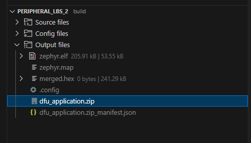

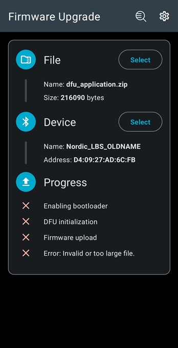

    Here are the steps I am following (with screenshots of key steps).
    1. I pristine build Version 1.
    2. I erase and Flash Version 1 onto my Dev Kit
    3. I pristine build Version 2.

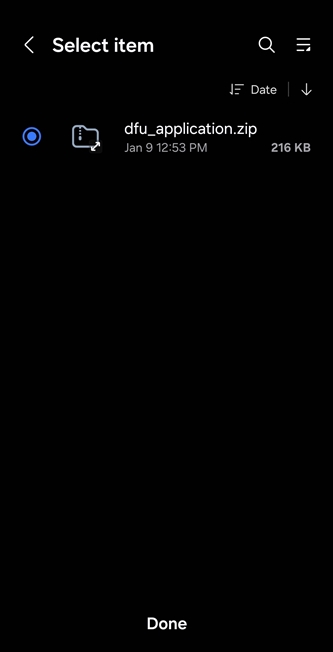

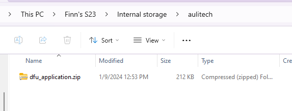

    4. I take the output file "dfu_application.zip" and transfer it to my phone

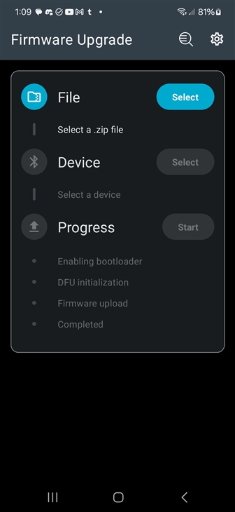

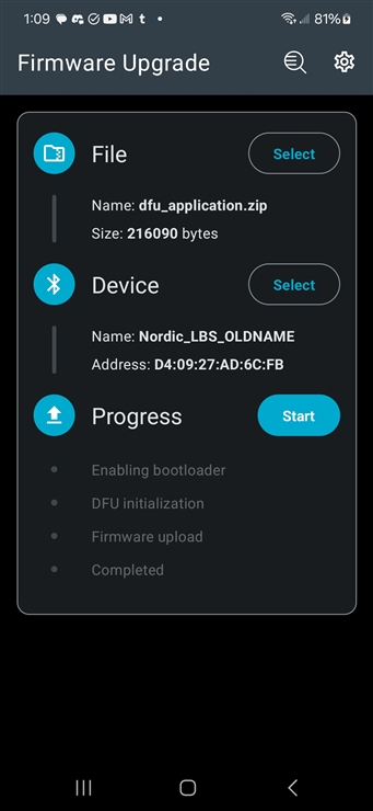

    5. On my phone, I open the app nRF Device Firmware Update
    6. Select File
    7. Select Device
    8. Click "Start"

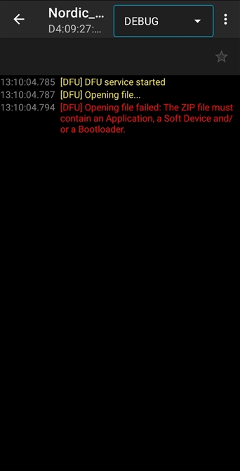

    Log from nRF Logger:

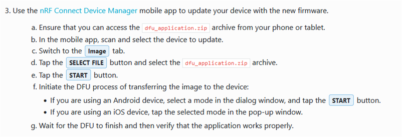

    Also, yes, I am following the link you sent (fota-update), but I'd like to point out a discrepancy between your advice and that tutorial. You mention that I should be using the nRF Connect DFU mobile app, but the instructions specifically call out using the nRF Connect Device Manager mobile app.

    I'm glad that you got it work now. The nRF Connect DFU mobile app is like a Swiss Army knife it can do everything, including DFU update for both nRF5 SDK bootloader and NCS bootloader. I was suggesting the app because it was more versatile. But it's better to use the app dedicated for DFU as the source code is available and you have more option to configure the DFU update.
