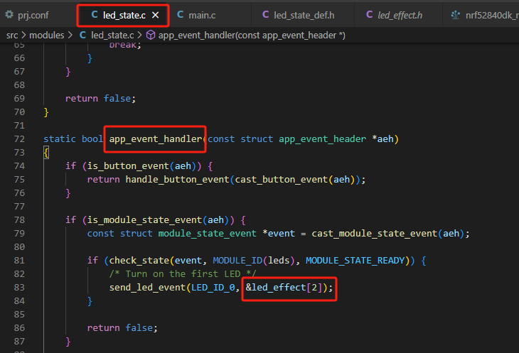

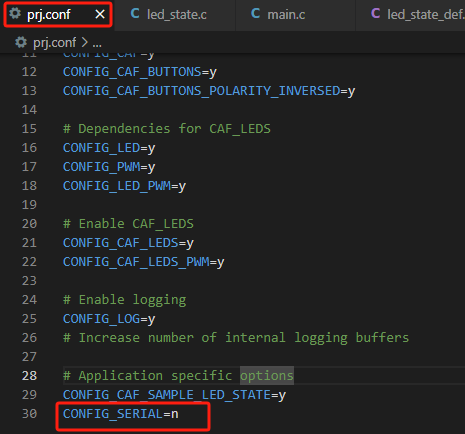

    The NCS development is based on version V2.4.1. The project example to reproduce the issue is located in nrf\samples\caf. However, certain modifications are required in specific parts of this process. The default state of the LED in the project is to turn it on, but to replicate the issue, it is necessary to implement a breathing effect for the LED. Additionally, in the project configuration, the serial port needs to be disabled, as shown in the diagram below:

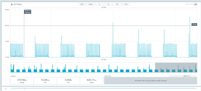

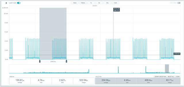

The power consumption of a normal module is shown in the following figure.

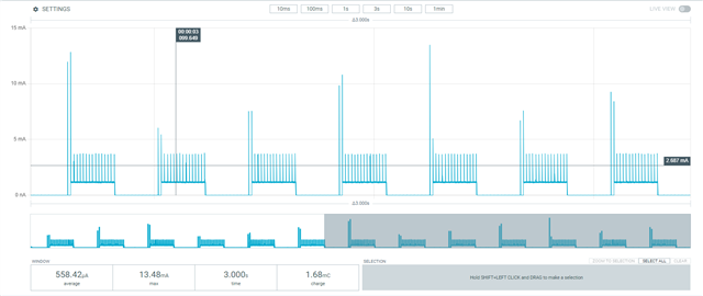

The power consumption of an abnormal module is depicted in the figure below.
I have not conducted power consumption testing on the nRF52840 DK board because it is not easy to operate. However, the power consumption of our normal modules is generally consistent. The power consumption of the abnormal modules provided by the customer differs by several hundred microamperes. Currently, we have only received two abnormal modules. Interestingly, the three existing test modules we have do not exhibit this abnormal behavior. The hardware design of the existing test modules and the modules delivered to the customer is identical.

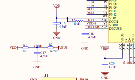

I am unsure where to start troubleshooting as I do not know the specific points of the issue. However, my intuition suggests that it may be related to the DCDC part of the nRF52840. I hope you can provide a solution and explain the reasons for the inconsistent chip power consumption. This information is crucial for us to communicate effectively with the customer. Thank you very much!
