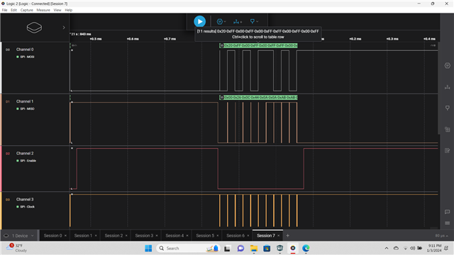

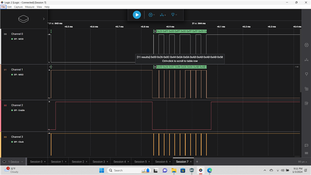

Here is our issue, with our nRF905, we are able to write to it, however we are only able to read from our rf configuration register.  Regardless from what instruction set we use; we are only able to read from our configuration register.  We have verified that we are sending the correct instructions by using a logic analyzer.  We have also verified that our nRF905 is good by swapping out several and obtaining the same results multiple times.  When we read from our configuration register, the input data continues to loop configuration register values.  We are hoping the issue is simply something being overlooked, as we are only students using the nRF905.
We are also looking for nRF905 libraries in C language, as we were unable to find anything in specifically C online.  Does Nordic have any example code or demonstration code available in C for the nRF905?
Included are screenshots of our logic analyzer capturing data from instruction 0x20.  Using this instruction, we plan on writing to the transmitter payload register.  Here, the nRF905 is only outputting portions of our configuration values in semi-random order.  This occurs for every instruction set.  Any ideas how to access any other register values or what issues may be occuring?
