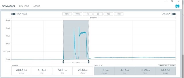

    1.This is my observation from the power profiler, and I have attached an image from the power profiler for your reference.
    which is
    "BT_GAP_ADV_FAST_INT_MIN_1 = 0x0030" and "BT_GAP_ADV_FAST_INT_MAX_1 = 0x0060,"

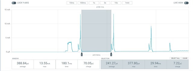

    2.After changing this value i get this
    "BT_GAP_ADV_FAST_INT_MIN_1_10ms = 0x0008" and "BT_GAP_ADV_FAST_INT_MIN_1_20ms = 0x0016,"
    Thank you for the clarifications.
    Please note that the advertising interval is defined as N*0.625 ms, which in your case places the min and max at 5-10ms, which is lower than the lower boundary for advertising intervals (except for high-duty directed advertising) which is 20 ms.
    There will also be added a random delay of 0-10 ms to your advertising interval, to avoid repeated collisions, which you can see in the power profiler trace.
    This slipped my mind earlier, apologies for any confusion this might have caused! :)
    Still it is strange that you did not see any returned error codes, however - perhaps the logging is not set up correctly.
