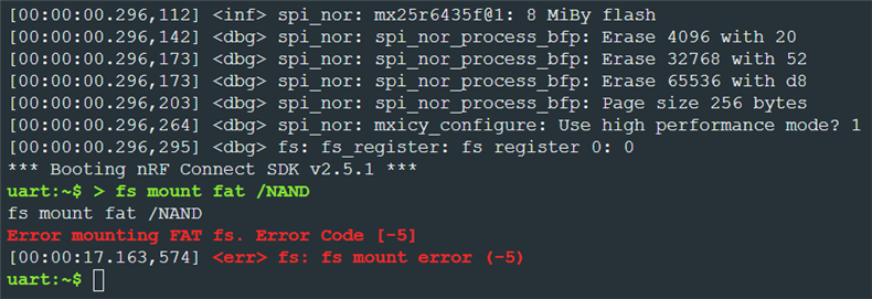

Hello
I am using the nRF9160-DK and I would like to access the external flash memory (mx25r6435f), as a FAT format file system. To do that I have made a 'test project' to access the file system from the SHELL, as a starting point.
I can access the flash memory successfully using the flash command in the shell, as you can see in the following picture.
But when I try to mount the filesystem it gives me the error code -5, as you can see in the next picture.

    The fs shell sample seems to be mainly targeted towards littlefs:
    https://docs.zephyrproject.org/latest/samples/subsys/shell/fs/README.html
    I am unable to get it to mount properly when running your code on my side, even with other boards (nrf52840 etc), so I suspect there's something strange with the shell fs backend
    Even if I took the zephyr/samples/subsys/fs/fat_fs sample, and then added SHELL=y / FILE_SYSTEM_SHELL=y, it did work, as the FS was mounted by the firmware running:

    It looks like the firmware has to manually mount the volume first.
    PS: When using nrf9160dk_nrf9160_ns, you will invoke partition_manager, which uses pm_static.yml for static allocation of your partitions.
    You can then declare it similar to this (change addresses and sizes to your liking):

  • Hello Hakon
    I have made some progress since yesterday.
    The shell fs backend was not the problem as I had tried to mount using the fs_mount(&fs_mnt); function, that was returning the same error (-5).
    With some changes I managed to make it work, but only works using the SDK v2.4.2.

    Using these changes on the SDK v2.4.2, it works. It successfully mounts, read and write the external flash.
    When I compile this code using the SDK v2.5.1 I get compiling errors. The error appear only when the
    CONFIG_DISK_DRIVER_FLASH is enabled.
    But when CONFIG_DISK_DRIVER_FLASH is not enabled (was not included in my original post) the project compiles, but the disk would not mount. So it looks like to mount the disk it needs to enable CONFIG_DISK_DRIVER_FLASH.
    As I mention, on the SDK v2.5.1, when I enable CONFIG_DISK_DRIVER_FLASH I get the following compile error:
    My apologies for not seeing this.
    The pm_static.yml needs some extra parameters, similar to what is posted here:
     RE: Problem with flashdisk and partition_manager
    Could you try this and see if it builds/runs properly afterwards? Note that you might need to delete your build folder and regenerate the project.
    Håkon
  • Hello Hakon
    Following your suggestion I managed to make it work using littlefs file system.
    I add the following pm_static.yml file:

    Also I made a few changed to the prj.conf file to use littlefs

    At this moment I can use littlefs for my application so I will use littlefs as it is.
