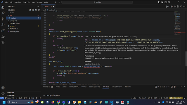

  • Thanks! I made progress programming directly with I2C. I tried switching devices to the LSM6DSO32 and using the Zephry sample. I almost got it work, but if fails here:
    const struct device *const dev = DEVICE_DT_GET_ONE(st_lsm6dso32); //compile error
    I am new to Zephyr. I thought I set everything up correctly, but I am missing something. Can you take a look at my attached to see if it's something obvious?
    https://github.com/mej558/lsm6dso_7.git
    	// const struct device *const dev = NULL; // this compiles...

  • I think you get this error because it can't find any driver for the device.
    I can't find any driver implementation for LSM6DSO32, although it has a devicetree definition, and there seems to be no reference to this in the Kconfig reference.
    Adding "CONFIG_LSM6DSO=y" in the prj.conf, chanding DT overlay to "compatible = "st,lsm6dso";" and changing main() to "DEVICE_DT_GET_ONE(st_lsm6dso);" resolves the build errors on my end, but I do not have the device to test if the application works with these changes.
