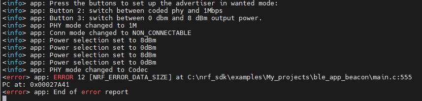

I have the following NRF_ERROR_DATA_SIZE error using the 1adv_seg compilation environment, please use only this one (in which the tx power change works properly):
The error is in this line:
This worked for me before because I had commented those lines, but when I scanned the adv in Codec mode I realised than it did not contain any advertisement data to obtain and analyze, so I uncommented the lines and the error arose.

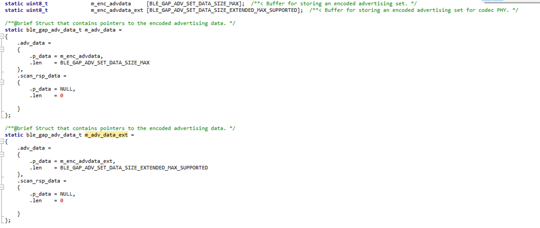

I also tried to create a new ble_gap_adv_data_t m_adv_data, defining the len of the p_data defined by other buffer for extended advertisers, as is shown in the image:
Therefore, my issue is inside the ble_advdata_encode for extended advertisements using Codec, and I do not know where is the problem, please if you would help me.

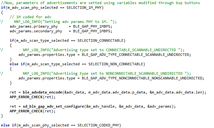

    You seem to be using the incorrect BLE_GAP_ADV_TYPE when starting advertising with the coded PHY. This PHY is only supported with extended advertising. Please implement the changes below and let me know if it works or not.
    @@ -512,12 +511,12 @@ static void advertising_init(void)
             if(m_adv_scan_type_selected == SELECTION_CONNECTABLE)
        //         NRF_LOG_INFO("Advertising type set to CONNECTABLE_SCANNABLE_UNDIRECTED ");
    -            adv_params.properties.type = BLE_GAP_ADV_TYPE_CONNECTABLE_SCANNABLE_UNDIRECTED;
    +            adv_params.properties.type = BLE_GAP_ADV_TYPE_EXTENDED_CONNECTABLE_NONSCANNABLE_UNDIRECTED;
             else if(m_adv_scan_type_selected == SELECTION_NON_CONNECTABLE)
        //         NRF_LOG_INFO("Advertising type set to NONCONNECTABLE_SCANNABLE_UNDIRECTED ");
    -            adv_params.properties.type = BLE_GAP_ADV_TYPE_NONCONNECTABLE_NONSCANNABLE_UNDIRECTED;
    +            adv_params.properties.type = BLE_GAP_ADV_TYPE_EXTENDED_NONCONNECTABLE_NONSCANNABLE_UNDIRECTED;
             ret = ble_advdata_encode(&adv_data, m_adv_data.adv_data.p_data, &m_adv_data.adv_data.len);

  • Yes, the first block of code you posted is inside condition: if(m_adv_scan_phy_selected == SELECTION_1M_PHY). The block:
    So I think that my initialization is correct in mode 1M.
    The second block is referred to m_adv_scan_phy_selected as Codec PHY. And the m_adv_data_ext is another structure that i used for initialising the m_adv_handle for this mode. And I do not modify this structure anywhere
    Here is the question, should I use the same ble_gap_adv_data_t structure for both phy modes? If it is, I should define the ble_gap_adv_data_t->adv_data->p_data  m_enc_advdata array as BLE_GAP_ADV_SET_DATA_SIZE_EXTENDED_MAX_SUPPORTED, right?
    But by this way, I would send many unnecessary data when using 1M PHY mode...
    So, which is the way to create these structures and changing each other as change the PHY mode?
    Thanks.
