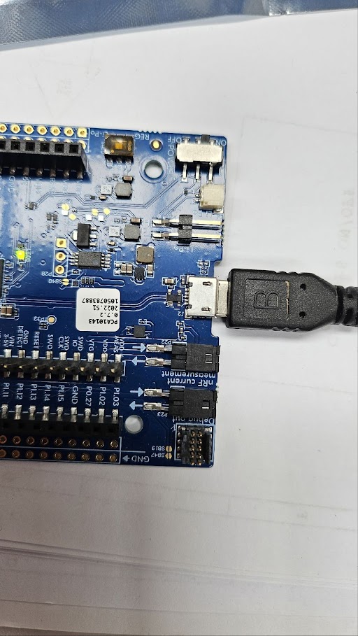

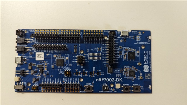

  • Hi Sylvain
    With that version of the DK NCS 2.5.0 should by default build for that chip revision, so that shouldn't be the issue. Can you send a (high-res) picture of your DK, and some information on how you're posing it and what the switches on the DK is set to?
    The error messages you get is telling you that you're not able to communicate correctly with the nRF7002 chip for some reason, so I just want to see that the DK seems to be correctly set up.
    Simon
