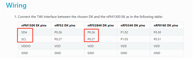

We can achieve that use nPM1300-EK when first power up.

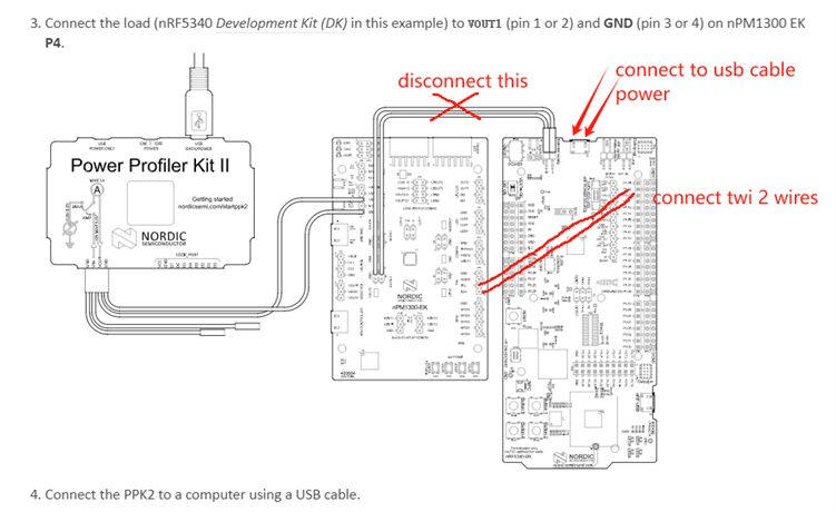

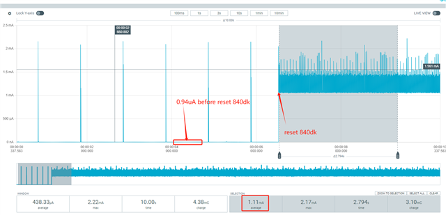

But when we connect to pc use nPM PowerUP and disconnect. The  nPM1300-EK quiescent current will go up to 1mA.
And when we connect to nrf52840-DK And run npm1300_fuel_gauge example and disconnect. The nPM1300-EK quiescent current will go up to 3.7mA.
Is there any way to make the quiescent current below 1uA  without enter SHIP/HIBERNATE Mode ?
Thanks

  • Hi Andy,
    We add the overlay to the project and the quiescent current go down to 1.0mA.
    Is there any other config change we can make the quiescent current below 1uA?
    Thanks
    Chen

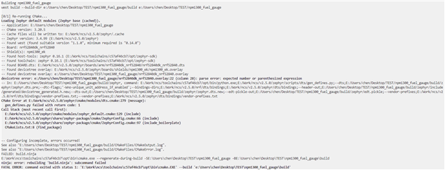

  • Hi Andy
    the build unsucceed after add the overlay in sdk v2.5.0
    the nrf52840dk_nrf52840.overlay

  • Hi Chen.
    Could you add this to the top of your overlay and try again please:
    #include <dt-bindings/regulator/npm1300.h>
    Thanks
    Andy
  • Hi Andy ,
    Still cann't buid succeed , attach is npm1300.h from sdk there was no NPM1300_BUCK_MODE_PFM

  • Apologies, I am working on upstream Zephyr so forgot that this change was not in NCS2.5.
    Another thing to try:
    1. Remove the init-microvolt property, so that it uses the default value from the resistor
    &npm1300_ek_buck2 {
        /delete-property/ regulator-init-microvolt;
