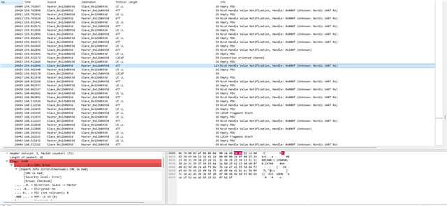

Hi i am developing application that utilize SAADC and send it to pc by ble_nus service
my goal is to acheive 250Hz sampling frequency which means i have to send data packet  every 4ms.
i used nrf52840dk as adc role and nrf52840 dongle as interface to PC
when DK and dongle are in close distance, they are able to send packet every 4ms quite well
but when i put dk at a distance, sending rate decreases to about 200Hz,
worst case was 170Hz for ~3m distance
depending on surroundings, even dongle and dk are close , data sending rate was very low.
i need application that can send packet as constant as i can robust to surroundings.
nrf sniffer when they are close

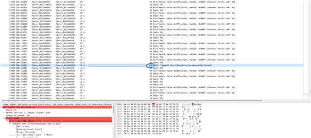

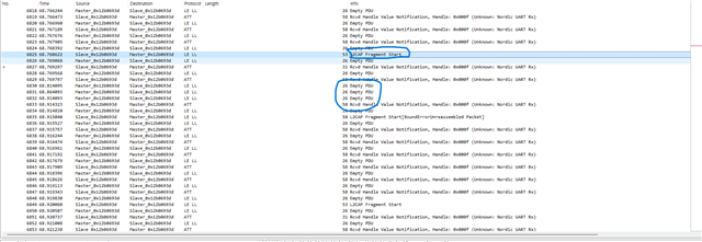

when distance increased, some empty pdu arise,

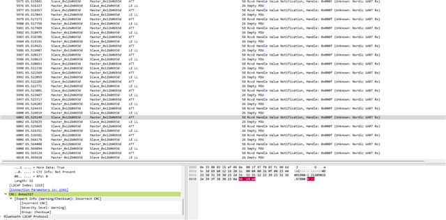

also i observe l2cap
also i observed above packet i can't figure out it's source
some arrived packet is followed by unknown strings
is there are any good approach to establish robust connection?
due to my lack of knowledge to ble, i could miss  a lot but
any advise would be a big help
conn interval = 50ms
MTU_size = 247
phy = 1m
tx power= 8dbm
i used ble_nus_send function
in nrfSDK v17
thank you very much
