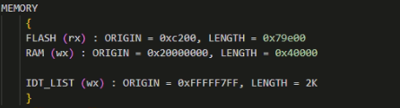

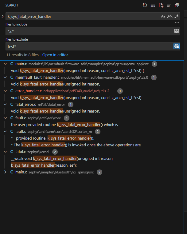

In any of the options, we always get the reason that it is a software reset when we cause a buffer overflow: "buffer overflow detected".
How can we get the reason that the reset was due to a buffer overflow error?
how to separate this from the usual call to reset the firmware?
