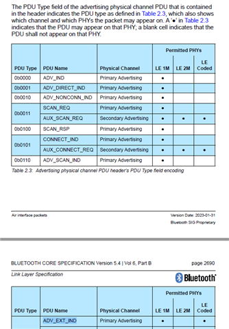

    We have no plan to support the feature as it's not allowed by the spec.
    Here is the response from my ChatGPT 4 to the question of "Does Nordic softdevice support advertising in CODED PHY using classic advertising?"
    If you're referring to using CODED PHY with the classic advertising scheme (i.e., the original BLE advertising method), this might be constrained by the BLE specification and the capabilities of the SoftDevice. It's more common to use CODED PHY with extended advertising due to the enhancements in Bluetooth 5.0 and later versions.
    For the most accurate and current information, I recommend consulting the latest Nordic Semiconductor documentation for the specific SoftDevice version you are interested in, or contacting their technical support. Nordic regularly updates their SoftDevice with new features and capabilities, so they would provide the most reliable information on what is currently supported.
    I did a follow up question about how it's constrained in the Bluetooth spec and got these info:
    Primary Advertisement Channels and PHYs: In Bluetooth 5.0, advertising on the primary channels (channels 37, 38, and 39) can be done using different advertising packets (PDUs). However, for the legacy advertisement PDUs, they can only be sent on the original LE 1M PHY. The only primary advertisement PDU that can be sent on a PHY other than the 1M PHY is the ADV_EXT_IND, which is an extended advertisement indicator. This means that for classic advertising, which uses the primary advertisement channels, the use of Coded PHY is limited to extended advertisements only.
    I think it's a proper answer. It's not allowed by the Bluetooth spec to do classic advertising in CODED PHY as you can find at page 2690 (v5.4) here:
    ADV_IND can only be used in LE 1M not LE CODED.
    Note that ADV_EXT_IND can be sent in both LE1M and LE CODED , but the ADV_EXT_IND doesn't include any data, it only the indication that there will be follow up packets in the data channel (extended advertising).
