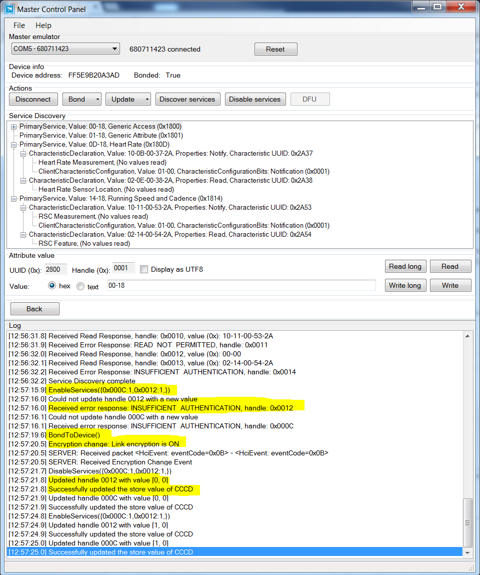

With Master Control Panel: I can connect the peripheral, but an attempt to bond failes after a timeout. Discovering the characterisitcs is possible, but the protected values can't be read.

    I have changed all open characteristics from BLE_GAP_CONN_SEC_MODE_SET_OPEN to BLE_GAP_CONN_SEC_MODE_SET_ENC_NO_MITM, in services_init().
    Then i connected with MCP for windows, and discovered services. This worked fine (as expected). Then i pressed "Enable Services". This failed since i had set up encryption requirement on the CCCD of both characteristics.
    Then i pressed the "bond" button. The bonding worked, and i was now able to enable services (write to cccd). image description
    I tried with Ligblue for iOS as well. Here i was only able to see the advertisement data. I would not emphasize results with Lightblue all too much. It has varying results from time to time.
    I guess the weird thing here is that your bonding failed with MCP. How many times did you try with the same result?
