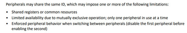

This throws an error that "i2c4" is an "unknown label", because it's not defined in `nrf5340_cpuapp_peripherals.dtsi`.
I can't double up on the peripheral indexes (e.g. `uart0` and `i2c0`), because they both share the same address in `nrf5340_cpuapp_peripherals.dtsi` and it throws an error saying "only one of the following peripherals can be enabled...".
Is there a way to define more then 4 UART/I2C/SPI peripherals on an nRF5340?
