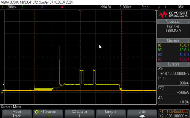

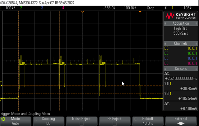

  • HI,
    I am also inquiring about the raw_tx_packet demo.
    I have also create a small app based on this demo where i change channels to 1,6,11 and send raw packets.
    here is the result of power profile - current.
    the channel switching itself is very slow and cannot be used in real world application. 756ms for 3 channels.
    same code without channel switching - you can see that the time it takes for sending 3 packets one after another on same channel in total is 20ms.
    is there any work done on this?
    thanks
    Dan

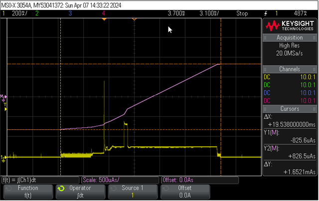

  • for completeness -
    1 channel 1 packet - power DK7002 ~20ms.
    changed sample to:
    1. transmit in legacy mode (802.11g)
    CONFIG_RAW_TX_PKT_SAMPLE_RATE_FLAGS 0
    2. enabled low power with this
    CONFIG_NRF_WIFI_LOW_POWER=y
  • You don't have any issue with code errors when switching channels?
    The datasheet is not published, Don't know how does the low level code implement . I am waiting the new version of this feature.
  • No, i don't have any LOG errors
    sdk 2.6.0
    and I can see the packets on the sniffer.
    but still this is not relevant for real world..
    opened a ticket
