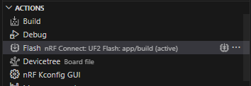

I can see that the UF2 flashing task is shown in the Actions tab :
But when I click on it this error appears, and it seems to loop indefinitely.
Is there a problem in my configuration ? Is the uf2 runner supported by the VSCode extension ?
