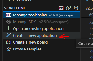

    Then try to open VS Code, and set the workspace to c:\nordic\ncs\v2.5.0. If you create a new application from the samples:
    And navigate to a sample from ncs\nrf\samples, and try to build it, what does it say then?
    Note that you don't need to use v2.5.0. You can use any version, like v2.6.0, which I am using in this screenshot. Make sure that the "Manage Toolchains" says the same version that you are using, and the "Manage SDKs" as well. If they don't, try changing them by clicking it.
