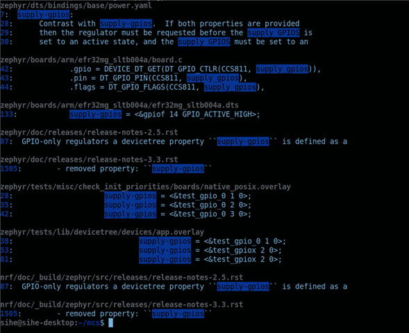

I'm currently writing a zephyr device driver for an accelerometer (ST lis2dux12). In our design this accelerometer is powered using a gpio port to make hard reboots of the sensor possible. The corresponding gpio is specified using supply-gpios:
	lis2dux12: lis2dux12@0 {
		compatible = "st,lis2dux12";
		reg = <0>;
		spi-max-frequency = <10000000>;
		irq-gpios =  <&gpio0 29 GPIO_ACTIVE_HIGH>, <&gpio0 30 GPIO_ACTIVE_HIGH>;
		range = <2>;
		power-mode = <0>;
		odr = <2>;
		supply-gpios = <&gpio0 24 GPIO_ACTIVE_HIGH>;
My question: Is Zephyr power management already doing something with this supply-gpios parameter, like setting it high during the boot of the device? Or should all the power-up logic be implemented in the driver itself? I could not find any documentation about this.
