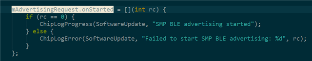

  • Hi Edvin
    thank you for your informationI used option 1 and sure it works.
    In addition, I expect that the BLE peripheral(nus) can connect to multiple devices at any point in time.
    But when I restarted the Advertising, it failed.
    example:C:\ncs\v2.5.1\nrf\samples\matter\lock
