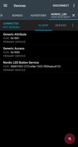

    Further, I don't even see the option to perform a DFU from the nRF Connect app:
    I tried this on 2 different nRF5340-DK boards and get the same result.

    The DFU option did appear on the nRF Connect app this time. Message after attempting to perform DFU:
