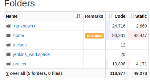

I am trying to use the `ram_report` tool and the results seem to have some issues:
1.  The total size reported is much more that that reported when linking the zephyr.elf executable.
2.  Data from the RO sections seem to be in the RAM report.
I used the location sample (nrf/samples/nrf9160/location).
west build -p -b nrf9160dk_nrf9160_ns
west build -t ram_report
The build gives a RAM size of 44472 bytes:
[314/316] Linking C executable zephyr/zephyr.elf
           FLASH:      144668 B       992 KB     14.24%
             RAM:       44472 B     211608 B     21.02%
        IDT_LIST:          0 GB         2 KB      0.00%
[316/316] Generating zephyr/merged.hex
The ram_report gives a total size of 67452 bytes:

The puncover tool provides a different RAM size, closer to that indicated by the linker:
Thanks!
