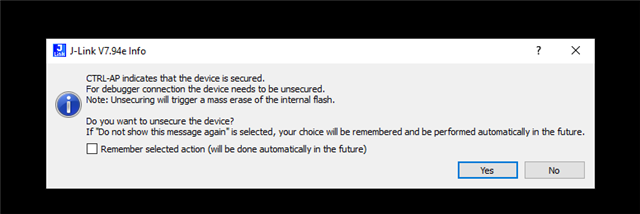

As it finally appeared to have been working, the CTRL-AP bit locking the code enabled itself. I cleared it with OpenOCD and telnet using nrf52_recover, which worked fine, but the lock re-enables itself after power cycling, but not after resetting.
This behavior persists when flashing code known to work, like the SDK blinky, which still gets locked after power cycling.
It also seems to... propagate? As I plugged a new unopened dongle which directly claimed to have the CTRL-AP enabled. I then plugged a new JLink (however no new targets left) which yielded the same result. I also reinstalled the JLink drivers and tried both the JLink software and OpenOCD which both have the issue.
Does anyone have an idea on what could be happening? The more things I try, the stranger it seems.
