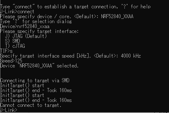

nRF52840DK cannot be debuged ("Programming failed with exit code 33")
[2024-Jan-23 13:58:24] [debug] --------------------------------------------------------------------------------
[2024-Jan-23 13:58:24] [debug] nrfjprog --recover --log

[2024-Jan-23 13:58:26] [trace] [  JLink] - JLINK_CORESIGHT_WriteAPDPReg(DP reg 0x02, 0x00000000)
[2024-Jan-23 13:58:26] [trace] [  JLink] - - 0.804ms returns -1
[2024-Jan-23 13:58:26] [trace] [  JLink] - JLINK_HasError()
[2024-Jan-23 13:58:26] [debug] [SeggerBackend] - ---just_abort_debug_action
[2024-Jan-23 13:58:26] [debug] [SeggerBackend] - Attempting to clear any configuration errors in debug port before closing connection.
[2024-Jan-23 13:58:26] [trace] [  JLink] - JLINK_CORESIGHT_WriteAPDPReg(DP reg 0x00, 0x0000001F)
[2024-Jan-23 13:58:26] [error] [ Client] - Encountered error -102: Command connect_to_emu_with_snr executed for 233 milliseconds with result -102
[2024-Jan-23 13:58:26] [trace] [  JLink] - - 0.549ms returns -1
[2024-Jan-23 13:58:26] [trace] [  JLink] - - 0.638ms returns -1
[2024-Jan-23 13:58:26] [trace] [  JLink] - - 0.692ms returns -1
[2024-Jan-23 13:58:26] [trace] [  JLink] - - 0.747ms returns -1
[2024-Jan-23 13:58:26] [trace] [  JLink] - - 0.773ms returns -1
[2024-Jan-23 13:58:26] [trace] [  JLink] - - 0.756ms returns -1
[2024-Jan-23 13:58:26] [trace] [  JLink] - - 0.812ms returns -1

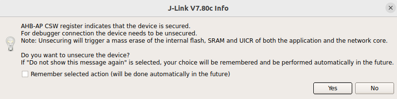

    If you open J-Link Commander (from your start-menu), are you able to successfully connect to the device then?
    Here's a way to connect using that program:
    device nrf52840_xxaa
    speed 125
    si 1
    connect
    This will set the correct device, nrf52840 in this case, use 125 kHz speed, select SWD, and lastly: connect.
    You can get a pop-up stating that the device is protected, similar to this:
    If it still does not run as expected, could you please send me a direct/private message with your contact details, so I can provide you with a replacement kit?

    Thank you for your advice.
    I tried JLink Commander tool, but it failed as shown below.
    Note that I tried it for the correctly working board and it was successfully connected.
    If you conclude this is HW problem after you see the above result, I'll talk to the agency in Japan "Kaga Device" that I bought my boards from.
    Thank you.
    Yes, I believe this is a hardware problem with the specific development kit.
    Håkon
