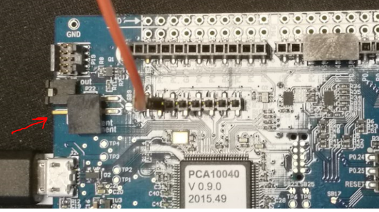

Temporary Solution:

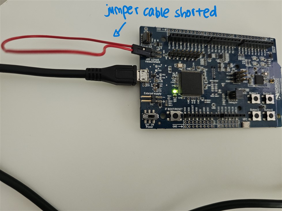

I am facing a similar issue from this link from 5 years ago, 'Recovery Failed. Unknown error' nRF52 DK - Nordic Q&A - Nordic DevZone - Nordic DevZone (nordicsemi.com). I was able to fix the issue by placing a jumper wire as shown in the below image. However, this solution doesn't work if I use in conjunction with PPK1. Also, this solution is very finnicky at times, it becomes very frustrating to work with.

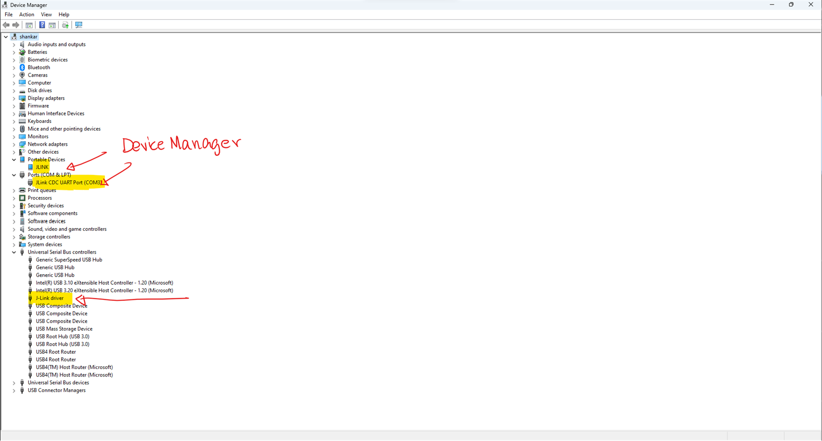

  • Screenshot from Device Manager,

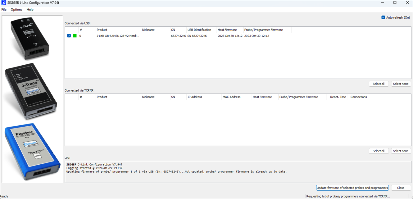

  • Screenshot from J link Configurator

3. Does the device show up in Device Manager on your computer? Please try to connect and disconnect the kit a few times. It might show up with unexpected names. (Yes, the device shows in the Device ManagerWhite check mark)

8. Try to open "j-link configurator" and see if your board is recognized there. (Yes, my board is recognized)

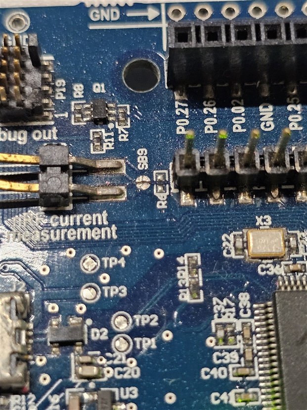

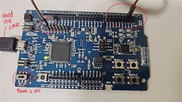

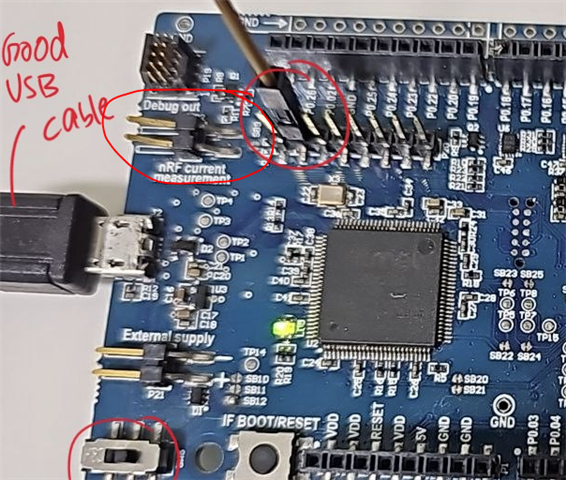

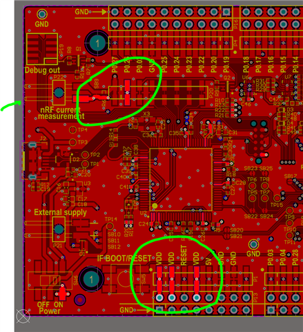

    Do you have the Solder bridge SB9 cut?
      (Looks like this image is from the other post but I dont see a jumper on P22 on your image)
    This is from your DK
    I dont see any sticker on this DK, what version of the DK do you have?
    From this image it looks like the jumper for power is not on correctly, if the SB9 is cut.
    AS for the unfortunate placment of the jumper cable, there are other places to connect to VDD
    You can route a cable on the underside of the DK to not take up space and block the PPK1
    Jonathan
  • Dear Jonathan, thank you for your response. I really appreciate it :))
    Image 1 : Closeup of the SB9
    After closely examining the microcontroller, i observed that the SB9 solder bridge has been cut.
    I am using nRF52832 DK. Unfortunately, I don't have the sticker since I received the nRF52 microcontroller from my professor.
    Solution:
    Image 2 : Jumper cable shorted to pin PIN22
    I used a jumper cable to short the pin P22.

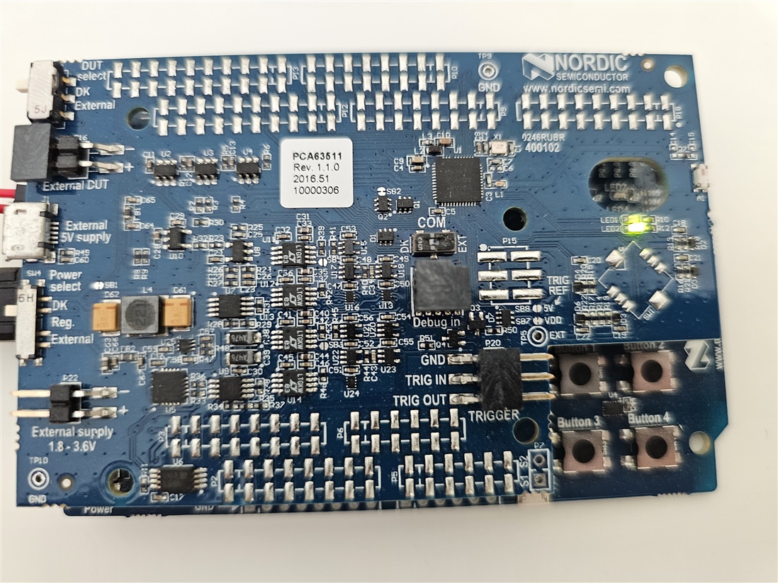

    Image 3 : LED2 lit on the PPK1
    As seen from the above image, the LED2 is lit on the PPK1, an indication that the PPK1 is working and the nRF52832 is working well.
    I placed a jumped cable on P22 since the solder bridge SB9 is cut. After placing my PPK1, the nRFConnect application automatically updated the firmware of PPK1 and it has been working well since then.
    Thank you, Mr., Jonathan LL for your help, really appreciate the quick response
