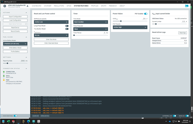

I have a npm1300-EK connected to nrf52832dk.
Power connected from npm1300 Buck2 3v to external supply nrf52.
  1. nrf52 is not usb connected.
  2. TWI connected to nrf52 P0.26,27
  3. USB PMIC is not connected.
I flashed "NPM1300_FUEL_GAUGUE" with the addition of "ret = gpio_pin_set_dt(&led, 1);" just to show the nrf52 is running
everything works as expected, except that when I push/push hold "SHPHLD" nothing happens. I was hoping/expecting SHPHLD to Power Down and/or Reset.
Are there a steps I can follow to get SHPHLD set up so that I can use the SHPHLD button to be a Power ON/OFF, (nrf52 hard reset)?
I attached my firmware.
  npm1300_fuel_gauge.zip
  • Hi
    From what I can see, the fuel gauge sample doesn't in fact use the SHPHLD. You can check out the nPM1300 One Button sample to see how the SHPHLD/RESET button is set up there to control the device state. Can you also share some details on how you're powering the nPM1300 on your end here, and how exactly the nPM1300 and nRF52832 DK is connected?

    I followed the suggested connections for npm1300->nrf5340dk, but on the nrf52832dk those pins are P0.19 - P0.24 instead of P0.10-P0.15
    ***VDD connected to VDDIO(npm1300ek) - I am getting connection problems when I close then open the PowerUp app. The problem seems like it might be tied to the VDDIO-VDD connection? Is this supposed to be connected?
  • Hi
    Sorry, this nPM1300_one_button sample is only available in the main branch and will be added in future versions of the major/minor NCS releases. You can find the one_button sample source code in the NCS GitHub here: https://github.com/nrfconnect/sdk-nrf/tree/main/samples/pmic/native/npm1300_one_button
    The setup seems fine, what connection issue exactly are you seeing when closing and opening the nPM PowerUp app?
