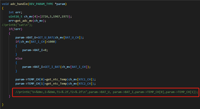

Hello, everyone! I am using the ADC nrf52832 to read the NTC temperature, and the NTC calculation formula is used in the application as follows:
#define NTC_B 3950.0
#define NTC_T2 298.15 //(273.15+25)
#define NTC_R 10000.0 //(273.15+25)
#define NTC_Rt(u) (u*NTC_R)/(VCC-u) // The unit mv
# define GET_NTC_TEMP (u) (1 / (log (NTC_Rt (u)/NTC_R)/NTC_B + 1 / NTC_T2) - 273.15 + 0.5).
But using that executes GET_NTC_TEMP () debugging information submitted to the following error:

  • Hello! My tests found that no error messages were printed when I turned off printk.
    The zephyr project enabled printk in accordance with the Developer Academy Basic tutorial, and an "MPU FAULT" error occurred when printing debugging information.
    The error information is as follows:
    U=4081mv,I=26mA,T1=17.66,T2=17.50
    [00:00:15. 566986] [1; 31 m < err > OS: * * * * * MPU FAULT * * * * * [0 m
    [00:00:15.566,986] [1;31m<err> os: Stacking error (context area might be not valid)[0m]
    [00:00:15.567,016] [1;31m<err> os: r0/a1: 0x52ca6621 r1/a2: 0xc50addbf r2/a3: 0x18853204[0m]
    [00:00:15.567,047] [1;31m<err> os: r3/a4: 0x214b5299r12 /ip: 0x52927c02 r14/lr: 0xa29a467c[0m]
    [00:00:15.567,047] [1;31m<err> os: xpsr: 0x41006200[0m]
    [00:00:15.567,077] [1;31m<err> os: s[0]: 0x00000001 s[1]: 0x00000011s [2]: 0x00000000 s[3]: 0x00023a21[0m]
    [00:00:15.567,077] [1;31m<err> os: s[4]: 0x9fa93901 s[5]: 0xcccccccd s[6]: 0x33333333 s[7]: 0x00000003[0m]
    [00:00:15.567,108] [1;31m<err> os: s[8]: 0x8dc502f0 s[9]: 0x00023951 s[10]: 0x1e4e1d05 s[11]: 0x00000004[0m]
    [00:00:15.567,108] [1;31m<err> os: s[12]: 0xcccccccd s[13]: 0xcccccccc s[14]: 0x8dc502f0 s[15]: 0x00023951[0m]
    [00:00:15.567,138] [1;31m<err> os: fpscr: 0x00029650[0m]
    [00:00:15.567,138] [1;31m<err> os: Faulting instruction address (r15/pc): 0x00029686[0m]
    [00:00:15.567,199] [1;31m<err> os: >>> ZEPHYR FATAL ERROR 2: Stack overflow on CPU 0[0m]
    U = 4080 mv, I = 26 ma, T1 = 17.69, T2 = 17.50
    [00:00:15.567,230] [1;31m<err> os: Current thread: 0x200019e0 (unknown)[0m
    [00:00:16.865,142] [1;31m<err> fatal_error: Resetting system[0m]
    If you run the printk application for a while, it will report the above error and restart; The above error does not occur when printk is removed and runs for a long time.

    Can not understand the cause of the above problems, ask for help! Thank you very much!
    Try to resolve the addresses listed in the assertion/fault log:
    Using arm-zephyr-eabi-addr2line, similar to as described here, but with your own faulting address:
     RE: Asset Tracker V2 - Crashes trying to read non-existent config
    This is RAM mapped address, consisting with which thread that was executed when the stack overflow occurred. If you open build-folder/zephyr/zephyr.map file in a editor and search for "200019e0" - which thread does this correspond to?
