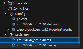

  • Ah, thank you for that help. The devicetree view gives a view similar to the pin configurator that other vendors provide. It is much easier to see all the pin assignments and conflicts there. That is what I've been looking for.
    The files in the build dir (both the .dts and .h) seem to contain all the information, but they don't seem easy to parse in a meaningful way.

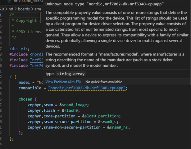

  • Aaron F said:
    On further investigation, I see that the overlay view in VS Code does have a squiggle underline for the conflict and does provide a pop-up saying there is a conflict when hovering over the underlined value.
    I am going to change this ticket to a feature request. Would it be possible to have this conflict cause a build failure, or is it considered valid to do this?
    Are you referring to yellow squiggly lines as shown in this image?
    Regarding the feature request we would prefer you raise the request in another ticket dedicated with that topic.

  • I am talking about this, with the squiggle under the pin number 13.
  • Ah, I see. Yes, this is as you've concluded in your discussion, i.e that the GPIO has been assigned to other nodes that is not "free to use" since it is predefined to be used to something else on the board. Another example is of course the GPIO's that are connected to NFC, buttons and LEDS. A build error is triggered if the configuration has faulty syntax, but it does not trigger a build error in this case since it is "valid" to overlay a GPIO pin select
    The best way to see the predefined assignments (in combination with examining the PS) is to see the board files. Board files are found under \zephyr\boards\arm, or in the extension
