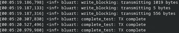

  • I have done some furhter research, and I now know that the big delay comes from the delay between calling bt_gatt_write_without_response_cb and the successful transmission of the data.
    [00:05:30.102,783] <inf> bluart: write_blocking: transmitting 1019 bytes
    [00:05:30.103,118] <inf> bluart: write_blocking: transmitting 5 bytes
    [00:05:30.103,302] <inf> bluart: write_blocking: transmitting 556 bytes
    [00:05:30.425,659] <inf> bluart: complete_test: TX complete
    [00:05:30.426,177] <inf> bluart: complete_test: TX complete
    [00:05:30.646,484] <inf> bluart: complete_test: TX complete
    as you can see in this log, there is a total of more than 500ms between calling the write function, and the execution of the TX complete callback. this is still with 90ms connection interval, and I changed the code so that every relay waits for the full payload and only relays it once its fully received, to limit the concurrent on-air traffic.
    the question now is, why is there such a long time between calling write and getting the complete callback? to me this still seems like an issue with the transmitting and would confirm my earlier findings that it is due to interference. Do you also think so? Or do you know of any other causes that would cause a delay there?

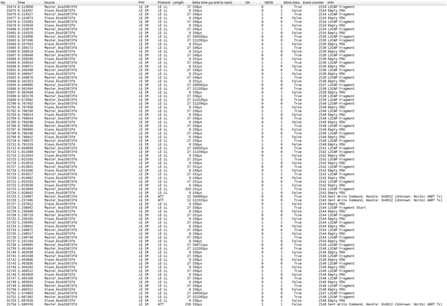

  • I managed to log another long delay and capture it with wireshark at the same time:

    can you spot anything abnormal? to me this still looks like Interference... but again, Im not a pro at this.
    also, why are there so many small fragments? I put 1Kb of data into the Zephyr write function and have set the data length max to 251, so why are there such small packets?
    I see that there is a lot of retransmissions. The most typical reason is noise or intererence, or low signal strength. But it could also be caused by other factors, like inaccurate or low frequency clocks on the devices (or misconfiguration, where you indicate that the clocks are more accurate than they are, so that the listening time (window widening) is not long enough.
    Regardign fragmentation I see you send short (normal) packets with a 27 byte payload. To send longer packets you need to use data length extension. You can refer to exersize 2 from lesson 3 in the Bluetooth Low Energy Fundamentals for seeing how to do that (essentailly calling bt_conn_le_data_len_update()).
