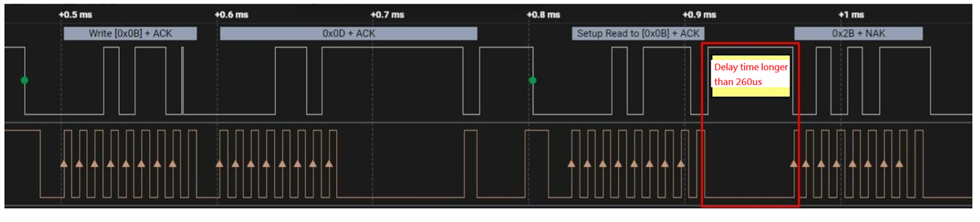

How to modify the timing at TWIM write/read sequence?
Hi
Below is from nrf9160 data sheet TWIM  section.
Using this sequence to a sensor device, we found sometimes the data read was incorrect. The sensor vendor said the root cause was the delay time
below was too short for their device to respond. Currently, it is 100us. How to enhance the time over 260us? Thanks
