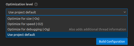

MPU FAULT running peripheral_lbs on v2.5.1
Shifting to v2.5.1 from v2.3.0 I start getting MPU FAULTS, on my own project (when establishing BLE connection).
So I tried the peripheral_lbs sample project. The MPU FAULT is still there:
