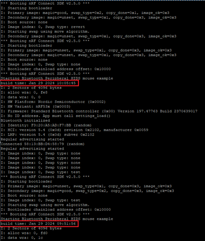

    Thank you for all your support. Per your suggestion, I added the two Configs. This has resulted in some strange behaviour from the build in visual studio. Please take a look at the error message below, I have bolded the relevant portion, and then underlined the paths to the key files:
    FAILED: zephyr/app_update.bin
    cmd.exe /C "cd /D C:\Users\Isaac\Documents\peripheral_hids_mouse\build\modules\mcuboot && C:\ncs\toolchains\c57af46cb7\opt\zephyr-sdk\arm-zephyr-eabi\bin\arm-zephyr-eabi-objcopy.exe --input-target=ihex --output-target=binary --gap-fill=0xff C:/Users/Isaac/Documents/peripheral_hids_mouse/build/zephyr/mcuboot_primary_app.hex C:/Users/Isaac/Documents/peripheral_hids_mouse/build/zephyr/app_to_sign.bin && C:\ncs\toolchains\c57af46cb7\opt\bin\python.exe C:/ncs/v2.5.0/bootloader/mcuboot/scripts/imgtool.py sign --key C:/ncs/v2.5.0/bootloader/mcuboot/mcubootenc-ec256-priv.pem --header-size 0x200 --align 4 --version 0.0.0+0 --pad-header --encrypt mcubootenc-ec256-priv.pem --slot-size 0x74000 C:/Users/Isaac/Documents/peripheral_hids_mouse/build/zephyr/app_to_sign.bin C:/Users/Isaac/Documents/peripheral_hids_mouse/build/zephyr/app_update.bin"
    As you can see, the path to the key file is wrong, and has somehow set itself to the location of the default key files that come with NRF SDK.
    Where did it get this path from, and how do I correct it?
    Earlier in the build it correctly located the key files:
    MCUBoot bootloader key file: C:/Users/Isaac/Documents/peripheral_hids_mouse/child_image/mcuboot/enc-ec256-priv.pem
    MCUBoot bootloader encryption key file: C:/Users/Isaac/Documents/peripheral_hids_mouse/child_image/mcuboot/enc-ec256-priv.pem
    EDIT: It seems to have worked, let me do a little more testing but somehow doing a second clean build seems to have worked.
  • Everything seems to now be working; I can successfully do an update with the correct key, and it rejects attempts to update with an incorrect key.
