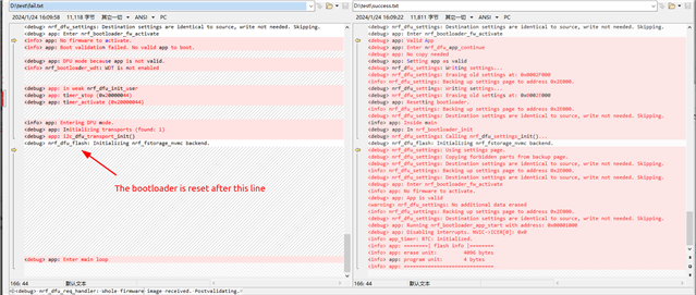

The upgrade HASH verification fails because the bootloader does not connect to the j-link RTT Viewer
For development using SDK17.1 and keil,Follow the examples in this document for development: Getting started with Nordic's Secure DFU bootloader, a step by step guide - Software Development Kit - nRF5 SDK guides - Nordic DevZone (nordicsemi.com)

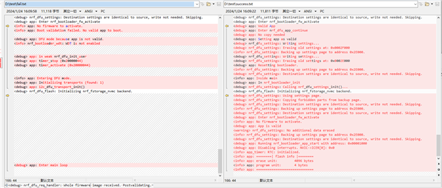

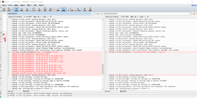

DFU (DFU-UART) is required. Due to project requirements, UART in bootloader is changed to IIC for DFU upgrade. A problem is that only the j-link RTT Viewer can successfully verify the HASH value.log Compare the following screenshot:
The current test outputs log information from the UART. j-link RTT Viewer selects Connection or no connection (If the chip is not connected, the HASH verification fails)

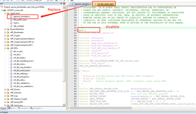

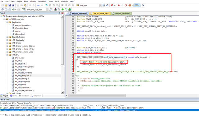

From UART to IIC, the following changes have been made:
Have been looking for a long time the cause of the problem, 52811_DFU.zip is the original program used for development.

    Please correct me if I'm wrong, but do I understand correctly that the bootloader only succeeds in retrieving the firmware image from your EEPROM device when the JLink RTTViewer is connected? In other words, does everything work as long as you are viewing the RTT logs? Does starting a debug session in Keil have the same effect?
    Vidar
  • Hi Vidar,
    Yes, you understand correctly, the HASH will only check if the JLink RTTViewer is connected (regardless of whether the log is output from RTT or not, because the log is also tested for output from UART, the same phenomenon).
    We'll test the way to start debugging in keil.
    Update a test case. When the IIC speed drops to 100K, the IIC can be upgraded without connecting to the JLink RTTViewer. In other words, the HASH check is successful.

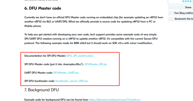

    Does the bootloader verify after the transfer is complete? If one of the packages fails, there is no error check inside, only the final HASH check, because I checked the reference code on the host side, each package seems to be sent without checking (program is: DFUMaster_SPI - downloaded in the connection given at the beginning)
    I can't understand the relationship between IIC rate, data clutter, and whether j-link is connected to the SWD port.
    Best regards
    Stars
  • Hi Starts,

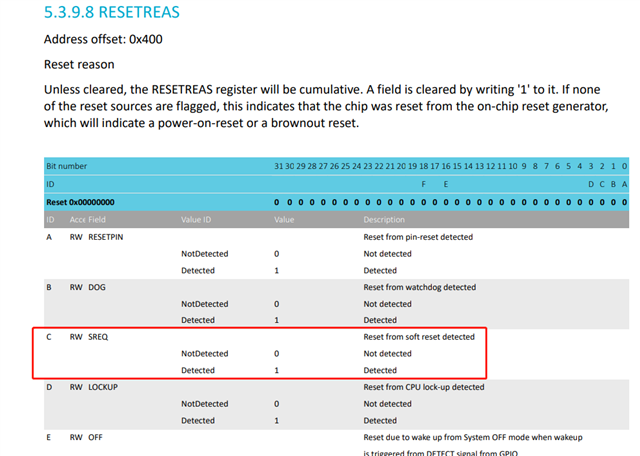

    This suggests that DFU works when the chip is in Debug Interface mode for some reason. The bootloader is being reset here:
    Please read out the RESETREAS register after this reset to find the reset source. You can use nrfjprog for this. E.g.,
    $ nrfjprog --memrd 0x40000400
    If it shows a lockup reset, then it may be similar to the problem discussed in this thread:  RE: Wierd hardfault
    Vidar

    Thank you so much for your guidance. TASKS_CONSTLAT = 1; The setup solved the problem.
    But nrfjprog --memrd 0x40000400 reads not lockup, but SREQ:
