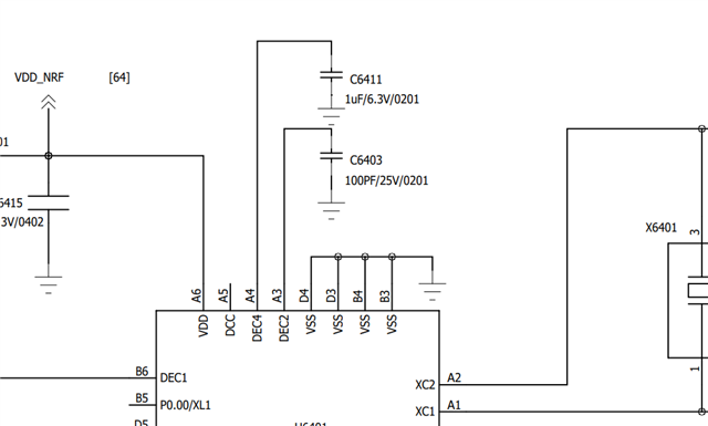

    It seems that the issue could be related to the voltage supply in your case. Have you measured your 1.8V supply under load to ensure that it does not drop below the min. supply voltage (1.7V) when the CPU and EEPROM are running?
    Is it possible to reduce the capacitance of the reference circuit so that this reduction in charge and discharge time can help us solve the problem? Or can you recommend how we can design to meet the normal operation of 1.8V VCC?
    I don't think you are facing the same problem as the other user. The chip is characterizied and verified with the component values used in the reference circuit.
    Does your design include the optional DCDC inductors? In that case, you could try enabling the DCDC regulator in your bootloader to reduce the peak currents.

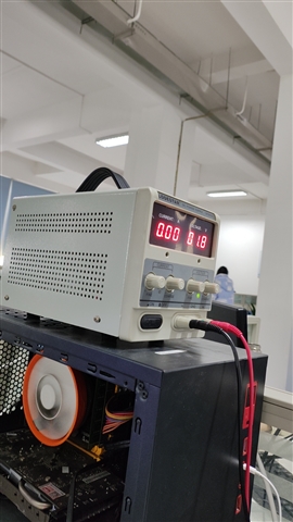

  • Hi Vidar,
    1.8V comes from a DC regulated power supply:
    However, in the test, it was normal when the VCC was 2V. Doesn't this reduce the capacitor charge.
    We don't have DCDC inductors:

  • Hi Stars,
    I don't think your bench supply should have any problems handling this load, but it might be good to measure the supply voltage using an oscilloscope to confirm that the voltage remains stable and accurate throughout the DFU process. Also, maybe double check if you are meeting the min. voltage requirement for your EEPROM.
