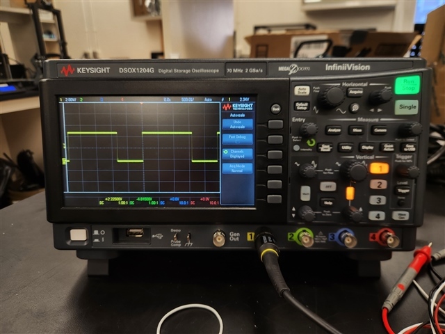

The servo motor is being controlled by toggling the serv2/serv3 GPIO pin (custom board) on and off with the appropriate delay. When connected with a short wire, the servo operates smoothly and responds to given signals. However, when we switch to a longer wire, the servo fails to respond at all. We are programming the custom board using the nRF5340 DK.
We have tried measuring the signals from the pin using an oscilloscope (images attached). As the wire gets longer, the signal becomes worse. The first image shows the expected signal (short wire) whereas the second image shows the signal we get from using a much longer wire.

    2024/1/30 UPDATE:
    Hello. we have also performed an experiment where we stripped the wire completely and measured the signal at different points. As we go down the wire, the signal goes from 5V logic to 3V/1V logic digitally (not a continuous drop). This results in a bad signal as we use a long wire. We believe that this is a microcontroller problem rather than a hardware/electrical issue based on the tests that we have done. Thank you again.
    Here are additional information on the experiment:
    In our experiment, we noticed something interesting with the signal along the stripped wire on our custom board using nRF5340dk. So, the stripped wire connects to the servo pin for the signal output. As we move down the wire, the voltage shifts from 5V to 3V in a digital way – not smooth.
    We checked the signal using an oscilloscope, we found that the amplitude of the square wave changes suddenly, as we progress down the wire. It's kind of a quick switch rather than a smooth transition. Attached some pics for a visual.

  • The MG92B is a 5 volt servo; the nRF5340 port pins cannot drive more than 3.6 volts absolute maximum regardless of port pin drive strength whereas the Arduino is using 5 volts. Some form of level-translator buffer is really required;  this could be a simple FET of some other driver.
    Worth considering changing the oscilloscope probe settings to x10 probe settings instead of x1, assuming there is such a switch on the probes. Sometimes a x1 probe can prove misleading since it loads the circuit with 1MOhm; x10 is 10MOhm.
    7 to 8ft is a huge distance in terms of port pins, by the way.
