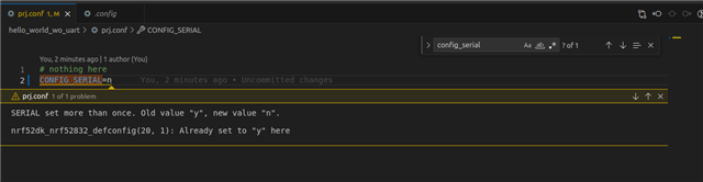

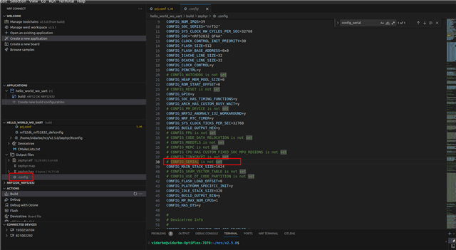

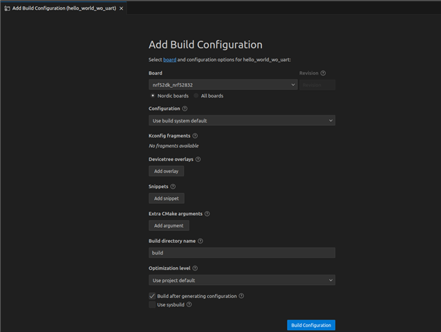

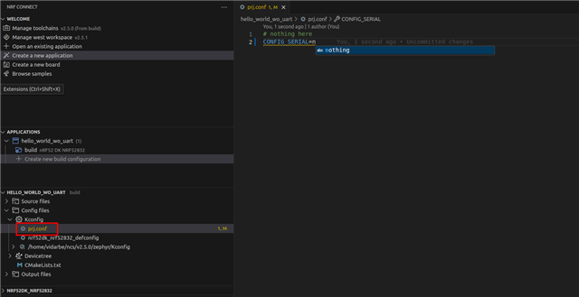

    Thank you for the clarification. I understood that you needed to change the default value in defconfig to disable 'CONFIG_SERIAL.' However, I assumed that you had two Kconfig fragments in your project source directory: 'prj.conf' and 'prj_release.conf.' And my initial suspicion was that perhaps you added 'CONFIG_SERIAL=n' to the latter, but that this configuration file was not the one actually used in your build. This is why I was asking earlier if you could verify whether the other settings in 'prj_release.conf' was being applied or not.
    Below are some screenshots showing how I would disable 'CONFIG_SERIAL' in a fresh project. Please let me know if you notice any differences in our approaches.
    Note: The extension may warn you that 'CONFIG_SERIAL' is already set to 'y' in defconfig. However, the symbol value from 'prj.conf' should take precedence, as confirmed by my .config output above.
  • I think what I didn't realize is that you need both prj.conf in addition to prj_[buildtype].conf. Thanks for clearing that up!
  • This depends on how the project is set up. I assume the prj_[buildtype].conf files only contain debug-related Kconfig settings in your case. That would explain why you need to merge the configuration with prj.conf. Normally, when you use 'Release' and 'Debug' build configurations, you should have one prj_debug.conf file that defines all the symbols needed for the debug build, and another prj_release.conf to build the release build.
