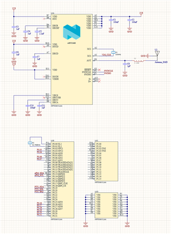

Cannot program nRF5340 custom board with SWD interface
Hello, everyone. I developed an nRF5340 PCB and in order to pursue the simplest possible circuit structure, the internal LDO mode is used for power mode. SWDCLK and SWDIO are retained for SWD download. But somehow I cannot download the program into it. In fact Visual Studio Code and JLink cannot even detect the existence of the nRF5340 chip which quite bothers me a lot.
The schematic and error messages are attached below. Look forward to reply, thx!
[2024-Jan-25 14:27:15] [debug] --------------------------------------------------------------------------------
[2024-Jan-25 14:27:15] [debug] nrfjprog --program /home/carefreeai/Test/test_for_new/build/zephyr/merged.hex --sectorerase --verify -f NRF53 --coprocessor CP_APPLICATION --snr 1050777944 --log
[2024-Jan-25 14:27:15] [debug] nrfjprog version 10.21.0 external
[2024-Jan-25 14:27:15] [ info] Load library at /opt/nrf-command-line-tools/lib/libnrfjprogdll.so.
[2024-Jan-25 14:27:15] [ info] Library loaded, loading member functions.
[2024-Jan-25 14:27:15] [ info] Member functions succesfully loaded.
[2024-Jan-25 14:27:15] [debug] [ Client] - open
[2024-Jan-25 14:27:15] [debug] [ Client] - start
[2024-Jan-25 14:27:15] [ info] [ Client] - stdout: Jlinkarm nRF Worker ready. Handling sequence 2e5b67ca-7f8a-4f9e-b029-a6842a10361f.
[2024-Jan-25 14:27:15] [trace] [ Client] - Command open executed for 5 milliseconds with result 0
[2024-Jan-25 14:27:15] [debug] [ Client] - config
[2024-Jan-25 14:27:15] [trace] [ Client] - Command config executed for 1 milliseconds with result 0
[2024-Jan-25 14:27:15] [debug] [ Client] - enum_emu_snr
[2024-Jan-25 14:27:15] [debug] [SeggerBackend] - Logger sink registered in Segger backend logger
[2024-Jan-25 14:27:15] [debug] [  JLink] - Logger sink registered in JLink logger
[2024-Jan-25 14:27:15] [debug] [  nRF53] - open
[2024-Jan-25 14:27:15] [debug] [  nRF53] - just_check_family
[2024-Jan-25 14:27:15] [debug] [SeggerBackend] - open_dll
[2024-Jan-25 14:27:15] [debug] [SeggerBackend] - No J-Link DLL path was provided. Attempting to auto detect.
[2024-Jan-25 14:27:15] [ info] [SeggerBackend] - Load library at /opt/SEGGER/JLink/libjlinkarm.so.7.86.6.
[2024-Jan-25 14:27:15] [ info] [SeggerBackend] - Library loaded, loading member functions.
[2024-Jan-25 14:27:15] [ info] [SeggerBackend] - Member functions succesfully loaded.
[2024-Jan-25 14:27:15] [debug] [SeggerBackend] - Set batch mode
[2024-Jan-25 14:27:15] [debug] [SeggerBackend] - dll_version
[2024-Jan-25 14:27:15] [ info] [SeggerBackend] - Segger dll version 7.86.f loaded.
[2024-Jan-25 14:27:15] [trace] [ Worker] - Command open executed for 3 milliseconds with result 0
[2024-Jan-25 14:27:15] [debug] [  nRF53] - config
[2024-Jan-25 14:27:15] [debug] [SeggerBackend] - enum_emu_snr
[2024-Jan-25 14:27:15] [trace] [ Worker] - Command config executed for 1 milliseconds with result 0
[2024-Jan-25 14:27:15] [debug] [  nRF53] - enum_emu_con_info
[2024-Jan-25 14:27:15] [debug] [SeggerBackend] - is_connected_to_emu
[2024-Jan-25 14:27:15] [debug] [SeggerBackend] - enum_emu_con_info
[2024-Jan-25 14:27:15] [trace] [ Client] - Command enum_emu_con_info executed for 405 milliseconds with result 0
[2024-Jan-25 14:27:15] [debug] [ Client] - connect_to_emu_with_snr
[2024-Jan-25 14:27:15] [trace] [ Worker] - Command enum_emu_con_info executed for 405 milliseconds with result 0
[2024-Jan-25 14:27:15] [debug] [  nRF53] - connect_to_emu_with_snr
[2024-Jan-25 14:27:15] [debug] [SeggerBackend] - connect_to_emu_with_snr
[2024-Jan-25 14:27:15] [debug] [SeggerBackend] - ---just_enum_emu_snr
[2024-Jan-25 14:27:15] [debug] [SeggerBackend] - ---just_get_num_emus
[2024-Jan-25 14:27:16] [debug] [SeggerBackend] - ---just_connect_to_emu_with_snr
[2024-Jan-25 14:27:16] [debug] [SeggerBackend] - ---just_connect_to_emu_without_snr
[2024-Jan-25 14:27:16] [debug] [SeggerBackend] - Segger logging enabled.
[2024-Jan-25 14:27:16] [trace] [  JLink] - Firmware: J-Link OB-nRF5340-NordicSemi compiled Nov  7 2022 16:22:01
[2024-Jan-25 14:27:16] [trace] [  JLink] - Hardware: V1.00
[2024-Jan-25 14:27:16] [trace] [  JLink] - S/N: 1050777944
[2024-Jan-25 14:27:16] [trace] [  JLink] - OEM: SEGGER
[2024-Jan-25 14:27:16] [trace] [  JLink] - Feature(s): RDI, FlashBP, FlashDL, JFlash, GDB
[2024-Jan-25 14:27:16] [trace] [  JLink] - USB speed mode: Full speed (12 MBit/s)
[2024-Jan-25 14:27:16] [trace] [  JLink] - TELNET listener socket opened on port 19021
[2024-Jan-25 14:27:16] [trace] [  JLink] - WEBSRV WEBSRV_Init(): Starting webserver thread(s)
[2024-Jan-25 14:27:16] [trace] [  JLink] - WEBSRV Webserver running on local port 19080
[2024-Jan-25 14:27:16] [trace] [  JLink] - - 59.907ms returns "O.K."

  • Hi
    The J-Link doesn't seem to detect the nRF5340 at all. This sounds like an electrical issue more than an issue with your schematics specifically. How is your nRF5340 custom board powered, and how have you connected the J-Link device (programmer) to the nRF5340 exactly? My guess this is either the nRF5340 not being powered with a voltage matching the J-Link device, the J-Link not being connected with VDD, GND and the SWD pins on the nRF5340, or an issue with the soldering on the custom board, causing the nRF5340 not to run correctly and thus not being found by the J-Link device.
    Simon
