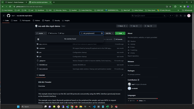

  • Thanks. Here is what I found with the BLE/ESB demo.
    I flashed peripheral_lbs sample to the 5340 to make sure I understood the sample. peripheral_lbs worked as expected. I could both read btn1 and set led3.
    C:\nrf\ncs-esb-ble-mpsl-demo:
    It seems that --board nrf5340dk_nrf5340_cpuapp_ns doesn't work, but --board nrf5340dk_nrf5340_cpuapp works.
    I included a screen shot and rezipped the demo, although I didn't modify anything I did do 3 nrf5340 builds, so in case I did something wrong there...

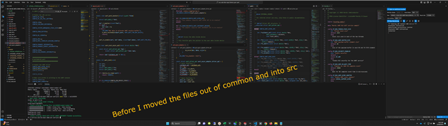

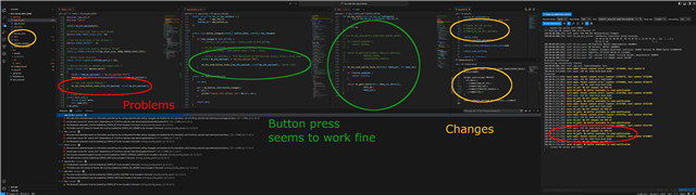

  • You make a great point. As development unfolds it's good to know I have the option... There will be redundancy in with the timestamp ACK responses every 5-10 seconds. Network traffic won't be much, but I do need to handle any occasional collisions. Packet length will be ~50bytes, so I'm guessing about <300µs transmission time. As long as I'm within a few ms I should be good. I'm sure there will be refinements once the system is working.
    I basically have the child (ptx) done and now it's time to circle back to the "parent" (prx). The parent relies heavily on your "ncs-esb-ble-mpsl-demo" as that is the node to split BLE and ESB duty.
    I made very minor additions to get LED2 to toggle (just to indicate successful BLE write). Compiled and everything works as expected.
    What I need to do now is replace the "peripheral_lbs" with "peripheral_uart" so that I can receive ESB rx_payload and relay it out over BLE and also push BLE data/commands out through ESB tx_payload.
    As always I am open to suggestions, but I've been trying to add "peripheral_uart" (which was compiled and working as a stand alone) to your ncs-esb-ble-mpsl-demo. "../common/uart_async_adapter.c" seems to be fine added to the CMakeList file, but if I add "../common/app_bt_uart.c" to the CMakeLists file I get compile errors that I don't understand.
    Is my approach sound or is there a better way of modifying your demo to use peripheral_uart? I also tried removing peripheral_lbs, but that didn't work any better.
    I've also loaded the prj.conf file with everything from peripheral_uart. Just that alone didn't cause any compile problems, but I noticed that even in the original demo there are warnings about missing CONFIG's that clearly exist in the prj.conf file (I don't fully understand why I am getting those warnings in the original demo, but it seems to be working correctly)
    I zipped the entire demo, with my additions, if it helps to look at it. I tried to follow your example for directory structure and to not modify anything I didn't have to.
    ../common/app_bt_uart.c is commented out in the CMakeList file, so that it compiles correctly, but uncomment that and you get the following errors.

  • Thanks! I'm still figuring Kconfig out and I understand what you mean with the app.overlay. I should have at least recognized the files existing in the peripheral_UART sample. I missed that one...
    I have (4) 52840dk boards that should be delivered today. In the meantime I added app.overlay to the demo-per-uart sample to accommodate the 52832. That allowed it to compile fine.
    However, I had warnings/errors in the prj.conf, uart_async_adapter and app_bt_uart files. I couldn't figure out how to fix that so I moved uart_async_adapter and app_bt_uart into the src folder, adjusted cmake, and all the errors went away in the c and the prj.conf files.
    I assume I needed to do more with either kconfig or cmake to get those files to work in the common folder, but I couldn't figure it out with the files in the common folder.
    I've gotten to 0 Errors/0 Problems in the compile. It seems very close, but I'm getting "<err> peripheral_uart: Cannot initialize UART callback".
    Given that this is the unmodified UART sample that runs fine as a stand alone, there must be something in the configuration that is still holding it back?
    It was problems with the "callback" that forced me to move the files out of "common" and into "src".
    ncs-esb-ble-mpsl-demo-per-uart.zip
