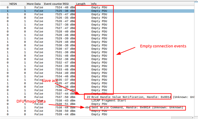

I am fairly certain it is not a connection issue, since I never had any issues with the old NordicDFU on the nrf5 SDK using the exact same board. Since I don't have a UART port for MCUBoot logging I'm not sure how I can diagnose this issue. Any help would be much appreciated
    but when trying to upload to the device using the nRF Connect app on iOS
    Could you try with https://www.nordicsemi.com/Products/Development-tools/nrf-connect-device-manager?

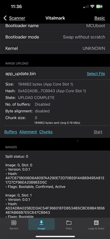

  • Hello Amanda,
    Thanks for your reply. I was able to successfully upload the image, confirm it, and reset the device. However, it was very slow (it took around 15 minutes). Is there any reason for this?

  • tonyh said:
    When I test the Peripheral LBS, I get much faster upload speed, around 5.5kbps.
    Do you test Peripheral LBS sample on the same board as your app? I found the board configs are different.
  • Yes, I used the default dk configs for the peripheral LBS sample.
  • The sniffer trace you provided suggests that the DFU transfer speed is not being bottlenecked by the connection parameters, but rather by the DFU target being very slow to acknowledge the write commands. As a result, the DFU controller spends most of the time just waiting for the DFU target to respond.
    Is it possible that the mcumgr transport workqueue thread is being blocked by your application for longer periods of time? Can you disable some of the application tasks to confirm this?
  • Hi Vidar, thanks for your reply.
    I finally found the issue: in one of my threads, I was incorrectly calling k_cpu_idle() and putting the entire cpu to sleep instead of just the thread I wanted. Thanks Vidar and Amanda for your help.
