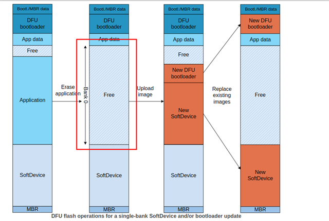

Having problems setting up a bootloader and application in the flash memory sectors. The program dies at sd_softdevice_vector_table_base_set(bootloader_addr); It looks like I have the bootloader in address 0x00019000;
which makes sense because the bootloader memory placement is as follows;

  • Here's what I think I understand now;
    1) The soft device is placed first within the flash
    2) The app is placed after that
    3) The bootloader is placed towards the end
    With this understanding I setup the memory placement with the app after the soft device;

    I assumed the app and bootloader could use the same ram.
    Therefore I loaded the bootloader. Then I loaded the application. This resulted in the program downloading and just started running at some random location without me pressing "go" and is just stuck there;
    They can use the same RAM area since they will never run concurrently. I recommend starting with the default bootloader linker settings used by the /examples/dfu/secure_bootloader/pca10056_s112_ble_debug example.
    Yes, this is correct. It is also the same as is shown here: Memory layout.

  • The error indicates that the new application does not fit into the free space here:
    What is the size of your application? Disabling logging in your application could help reduce the flash footprint (i.e. set NRF_LOG_ENABLED to '0' in sdk_config.h)
  • when i build in ses (132.9KB);
    the resulting hex file is 93KB.
    192 kB for nrf58211-QFAA-R, correct?
    Good call on removing logging, forgot about that.
    120.7KB in ses without logging.
    the resulting hex file is 59KB.
    oh *#&$ it works. thank you.
