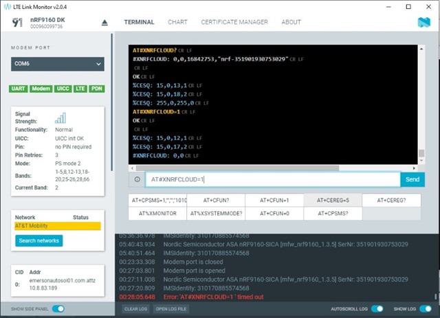

Not able to connect nrf cloud using serial ltm application

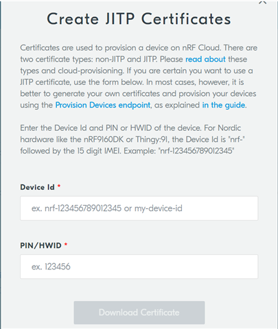

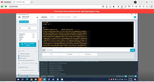

I have nrf9160 with AT&T sim card, I have used the serial LTM application.

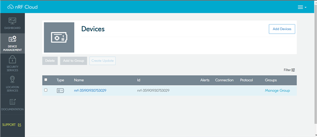

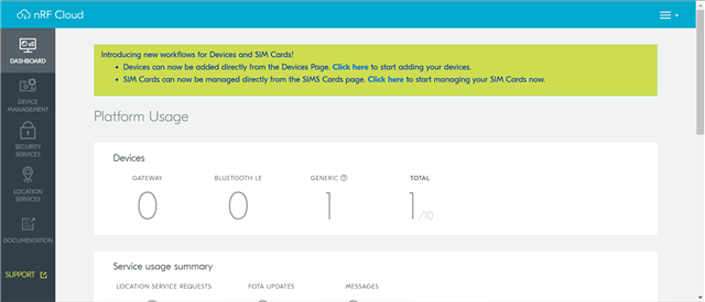

device is registered in nrf cloud with UUID provision method.

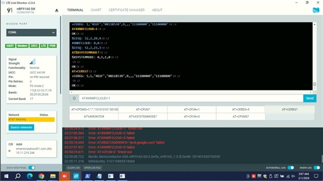

I execute the command AT#XNRFCLOUD=1 which gives me response as XNRFCLOUD: 0,0.

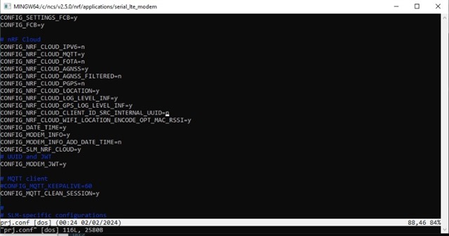

below is the configuration used in prj.conf file
CONFIG_SLM_NRF_CLOUD=y
using nrf connect sdk version 2.5.0 I am not able to communicate with nrf cloud.
