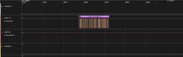

Anyways, I have flashed the board (I have tried both methods mentioned above) and both seem to work fine from the first glance. I have connected Saleae logic analyzer to monitor RX/TX pins and I can see that there is data being sent every 1 second which is what I expected to see:

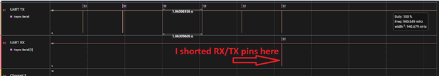

Question2:
Apart from the uart1_irq_transmit_handler, I also have the receive handler uart1_irq_receive_handler which I was hoping to use for data reception. So one handler is used for data transmission and the other one for the data reception.
However, that does not seem to work. In order to try data reception, I have simply shorted RX/TX pins, so whatever is being sent will be received. After shorting those 2 pins, I can see on the Logic analyzer that the data has been sent/received once:
But after that, it feels like UART1 transmit no longer works. It does not even transmit any data even when I disconnect RX/TX pins from each other. In order to fix this, I need to reboot the device and then the transmission works again until I short it. What could be wrong ?

  • Hello. I have made some progress regarding this. I have made some changes in the code and uploaded latest code to the project in the github repository I have linked previously.

    UPDATE
    After monitoring the RX/TX lines using logic analyzer everything seems fine:
    I am currently debugging to figure out what could be the issue with the UART1 receive:
