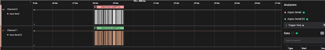

    What I want to achieve is very simple:
    I want to get the UART1 and UART0 working properly (receive and transmit) in interrupt mode.
    UART0 I use for logging and sending custom commands the device
    UART1 I plan to connect to an external device and I need to be able to receive/transmit various length messages but as I shown above currently I cannot get the transmit/receive to work properly on UART1 :)
    For some reason, I am convinced that the issue lies within incorrect implementation of uart1_irq_transmit_handler becuase I could not find any proper sample projects where it has been shown how to correctly transmit data over the UART in interrupt mode.

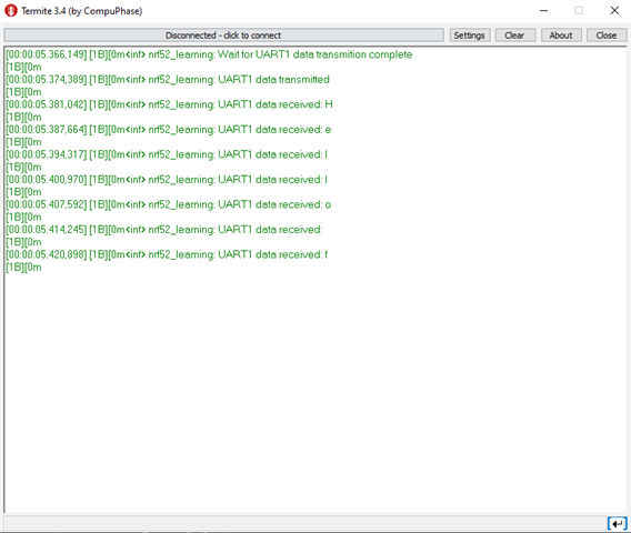

  • Hello. I have made some progress regarding this. I have made some changes in the code and uploaded latest code to the project in the github repository I have linked previously.
    The full code:

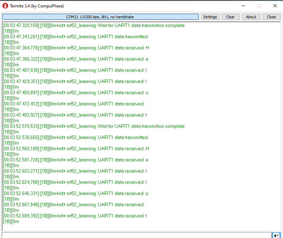

    As you can see from the code above, I have put tx and rx handlers into a single function (uart1_irq_handler). Previously I had 2 different interrupt handlers which is probably not correct.
    I can now short 2 UART1 pins together and I will be able to receive part of the message. See the serial temrinal logs below:
    I have send 17 bytes as shown below:
    	while (1)
    		k_msleep(5000);
    		uart_irq_tx(dev_uart1, "Hello from UART1\n", 17);
    But only received 7 bytes. I am happy that I have managed and currently working on solving this issue. Perhaps you will have some insights  :)

    UPDATE
    After monitoring the RX/TX lines using logic analyzer everything seems fine:
    I am currently debugging to figure out what could be the issue with the UART1 receive:
    I have found a very simillar post (Limited to reading 8 bytes per transmission on uart_fifo_read() Function ) but it does not seem to be solved.
    Could it be that there is an issue with using uart_fifo_read ?
    I have tested it with different length data. For example, if I try to send 4 bytes:
    uart_irq_tx(dev_uart1, "Hel\n", 4);
    Everything seems fine:
    [00:01:45.050,109] [1B][0m<inf> nrf52_learning: tx_sent: 4[1B][0m
    [00:01:45.070,495] [1B][0m<inf> nrf52_learning: Data to be sent length = 4[1B][0m
    [00:01:45.092,285] [1B][0m<inf> nrf52_learning: UART1 data transmitted
    [1B][0m
    [00:01:45.113,830] [1B][0m<inf> nrf52_learning: uart_fifo_read len: 1[1B][0m
    [00:01:45.135,192] [1B][0m<inf> nrf52_learning: UART1 data received: H
    [1B][0m
    [00:01:45.156,738] [1B][0m<inf> nrf52_learning: uart_fifo_read len: 1[1B][0m
    [00:01:45.178,131] [1B][0m<inf> nrf52_learning: UART1 data received: e
    [1B][0m
    [00:01:45.199,676] [1B][0m<inf> nrf52_learning: uart_fifo_read len: 1[1B][0m
    [00:01:45.221,038] [1B][0m<inf> nrf52_learning: UART1 data received: l
    [1B][0m
    [00:01:45.242,584] [1B][0m<inf> nrf52_learning: uart_fifo_read len: 1[1B][0m
    [00:01:45.263,946] [1B][0m<inf> nrf52_learning: UART1 data received:
    [1B][0m
    [00:01:45.285,461] [1B][0m<inf> nrf52_learning: UART1_RX(4): Hel
    However, anything above 7 bytes will not be properly received:
    *** Booting nRF Connect SDK v2.5.1 ***
    [00:00:05.364,227] [1B][0m<inf> nrf52_learning: tx_sent: 9[1B][0m
    [00:00:05.369,720] [1B][0m<inf> nrf52_learning: Data to be sent length = 9[1B][0m
    [00:00:05.376,617] [1B][0m<inf> nrf52_learning: UART1 data transmitted
    [1B][0m
    [00:00:05.383,270] [1B][0m<inf> nrf52_learning: uart_fifo_read len: 1[1B][0m
    [00:00:05.389,739] [1B][0m<inf> nrf52_learning: UART1 data received: H
    [1B][0m
    [00:00:05.396,392] [1B][0m<inf> nrf52_learning: uart_fifo_read len: 1[1B][0m
    [00:00:05.402,832] [1B][0m<inf> nrf52_learning: UART1 data received: e
    [1B][0m
    [00:00:05.409,484] [1B][0m<inf> nrf52_learning: uart_fifo_read len: 1[1B][0m
    [00:00:05.415,954] [1B][0m<inf> nrf52_learning: UART1 data received: l
    [1B][0m
    [00:00:05.422,607] [1B][0m<inf> nrf52_learning: uart_fifo_read len: 1[1B][0m
    [00:00:05.429,077] [1B][0m<inf> nrf52_learning: UART1 data received: l
    [1B][0m
    [00:00:05.435,729] [1B][0m<inf> nrf52_learning: uart_fifo_read len: 1[1B][0m
    [00:00:05.442,199] [1B][0m<inf> nrf52_learning: UART1 data received: o
    [1B][0m
    [00:00:05.448,852] [1B][0m<inf> nrf52_learning: uart_fifo_read len: 1[1B][0m
    [00:00:05.470,214] [1B][0m<inf> nrf52_learning: UART1 data received: 1
    [1B][0m
    [00:00:05.491,760] [1B][0m<inf> nrf52_learning: uart_fifo_read len: 1[1B][0m
    [00:00:05.513,122] [1B][0m<inf> nrf52_learning: UART1 data received: 2
    [1B][0m
    I would really appreciate if you could take a look at this. Perhaps this is a bug ?
