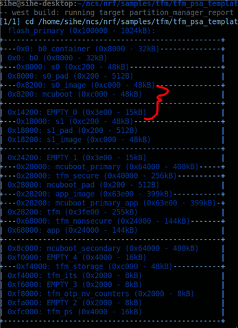

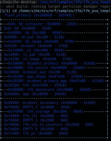

  • Eyo, I think I found something.
    Vefore we attend to your questions from the last comment, see the following:
    The tfm_psa_template gets a very similar partitioning to what you have, right.
    I then realize that the gap you have is to align this between 0x14200 to 0x18000.
    The gap is in other words because of the 0x200 pad, which you point out.
    Instead of putting the pad inside mcuboot, we can just decrease mcuboot by 0x200.
    If I configure CONFIG_PM_PARTITION_SIZE_MCUBOOT=0xbe00 inside the MCUboot child image configuration for this sample, I get the following, beautiful partitioning:
    I ran the sample and it did work as expected. Try this on your side as well.
