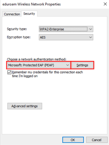

I am trying to solve the exercises from the Wifi Fundamentals course. This requires connecting for a wifi, but as this work is for my Thesis, I have to connect to the University`s wifi eduroam.
But to connect to eduroam, you should do it with your credientials, so each student have to use their username that is being given and a password that they also use for connecting to the University`s platform.
My question is, how could I connect with my device to this wifi? What can I write in the terminal and also in the code to succesfully connect?
I tried with using "eduroam" as SSID and for the PSK I tried the following formats:
  • "username: xxxxxx" "password: yyyyyyy"
  • "password: yyyyyyy"
  • "username: xxxxxx, password: yyyyyyy"
  • "{username: xxxxxx, password: yyyyyyy}"
  • "username=> xxxxxx" "password=> yyyyyyy"
I guess I just don`t know the format.

    hmojito said:
    I really have difficulties to understand why you cannot, when your official documentation is pointing that the chip is supporting WPA2/WPA3 Enterprise security...
    Please see my colleague's explanation in this post
    hmojito said:
    Another question, do you have knowledge about the possibility to use WPA2-Enterprise (especially EAP-TLS) security mode with this module? Nordic told me few months ago that this feature was in development but I can't find any information.
    Support for WPA2 and WPA3 Enterprise mode is currently not available. Please get in touch with your RSM for the timeline.
