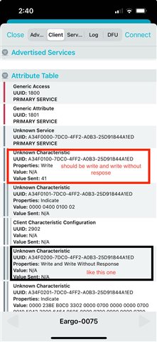

Cannot get ble characteristic with write_wo_resp to work
I need to update a characteristic to use write and write without response flags
I'm able to get this working on one of the characteristics but not the other
Running legacy nrf sdk 17.1
When I run this code, the ble characteristic shows up (on nrf Connect) as write only (with response required)

When I run this code (different UUID) it works and nrf Connect shows it having write and write without response abilities

Here is the nrf Connect output:
What am I doing wrong?
