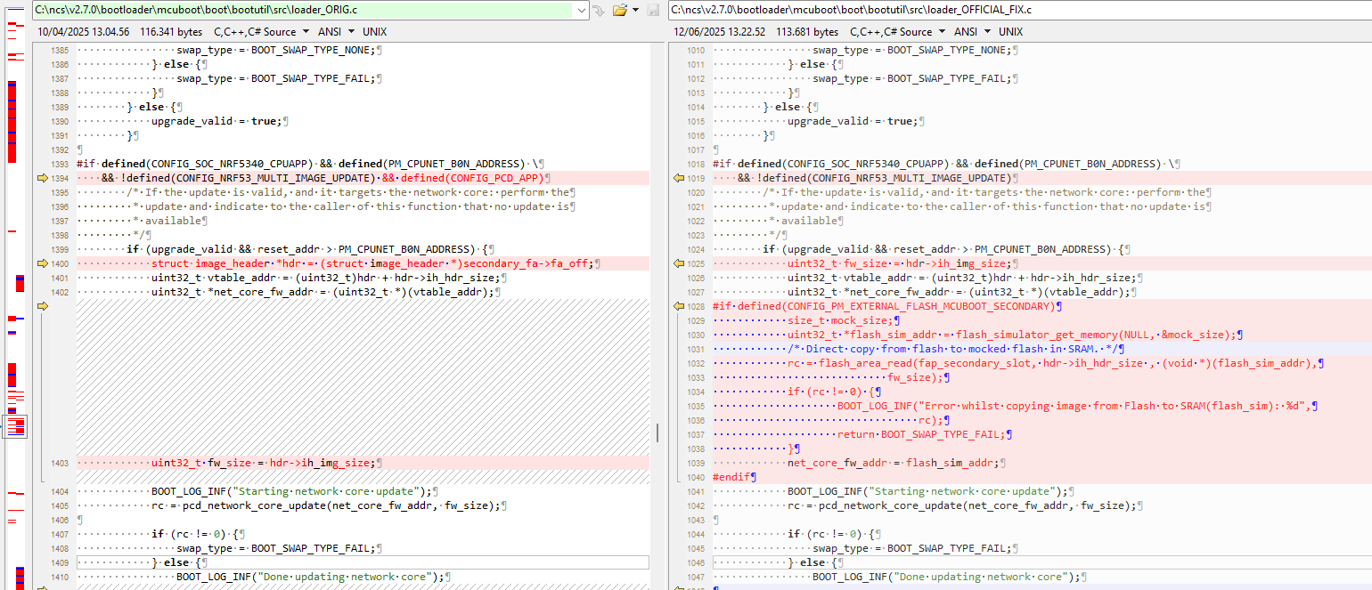

Firmware Upgrade known bug in MCUBOOT with nrf5340 and SDK 2.5.x
according to the known issues list for the SDK release 2.5.x x=[0,1,2] and others previous ones, the bug NCSDK-21379 exists (see the link below)
https://developer.nordicsemi.com/nRF_Connect_SDK/doc/latest/nrf/releases_and_maturity/known_issues.html?v=v2-5-2#dfu-and-fota
A workaround is also described.
Questions:
  1. Would you be so kind to be more specific by explaining in details what needs to be done in order to have the single slot netcore update working ? I remember that there was a similar bug in version 1.9.1 and also in 2.1.1, which we solved by applying a patch (there were some tickets regarding this topic). Is the known issue for the 2.5.x related to that in somehow ?
  2. An appcore built with sdk 2.5.x can work with a netcore built with 2.1.1 ?
Thanks in advance for your kind  availability !
