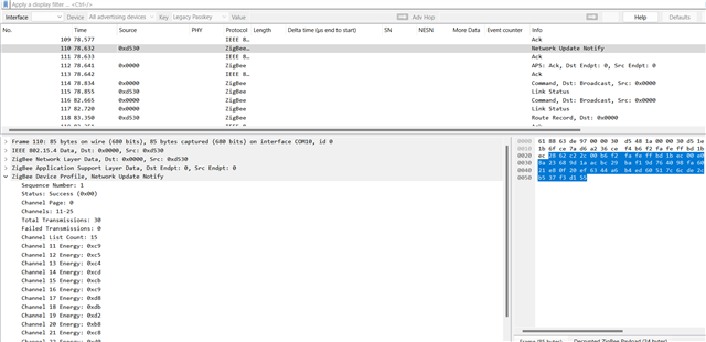

    With these changes, I could get the energy scan result as I could see from the debug prints and also from nRF Sniffer as below:
    Debug print:
    Fullscreen
    1
    cb status 0, scanned ch 67106816 list count 15 energy 201 197 196 205 203 201 216 219
    XXXXXXXXXXXXXXXXXXXXXXXXXXXXXXXXXXXXXXXXXXXXXXXXXX

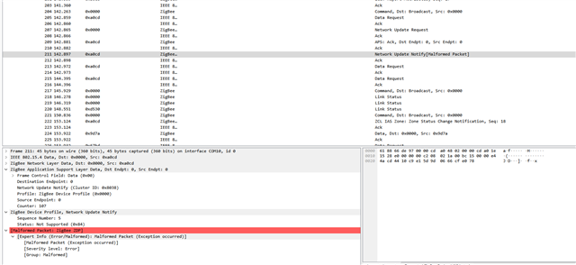

    Wireshark log:
    With these changes, I could get the Network Update Notify for routers that are bound to coordinator as seen above. So, I think I am framing the network update request for energy scan correctly. Please let me know if otherwise.
    However, for sleepy end devices, the response is Not Supported as seen here:
    So, is it not mandatory to implement this for Zigbee end devices, which are sleepy in nature?

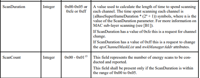

  • Hello Anusha,
    From the Zigbee specification, section 2.4.3.3.9:
    So duration is between 0 and 5, and it seems like scan_count should be set to 1.
    Edvin

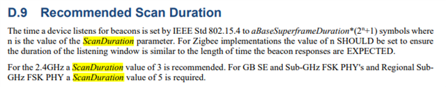

  • Hi Edvin,
    Thanks for your response. Yes, I already checked this in the specification. However, I wanted to check what were the values of the macros suggested in the example.
    Anyway, I saw a recommended in Zigbee specification where the suggested value for scan duration is 3.
