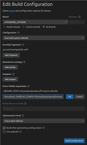

My second issue is that I have to add the `-Dmcuboot_OVERLAY_CONFIG=/home/laci/projects/firmware-uhk/uhk/device/mcuboot.conf` west argument every time I build because the VS Code forgets it:
How can I persist this setting? The "Save Configuration as Preset" option doesn't make a difference.

    With regards to issue where the VS code extension "forgets" the build setting, I will to try to reproduce it here. In the meantime, please consider creating a child image folder with your Kconfig file as I suggested in this post:  RE: Issues with Building MCUboot for nRF7002DK Using NCS V2.5.2
    Vidar
