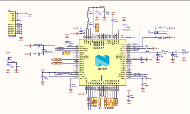

i add this but the code is Being stuck in while loop
it means the NRF_CLOCK->EVENTS_HFCLKSTARTED is zero
what is the problem?
hardware side?
It means that you external oscillator is not starting or giving a stable clock. Yes, sounds more like a hardware related issue with the external clock or the connections to it.
this is our circuit
what is your idea about shematic?
