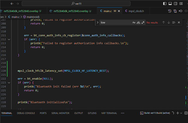

  • Hi katrindqawn,
    I had the same problem and it was caused by the high ramp up time delay of the high frequency external crystal. Have a look there: https://devzone.nordicsemi.com/f/nordic-q-a/107808/reset-with-hard-fault-after-bluetooth-advertising
    I solved starting the high frequency cristal before enabling ble subsystem, and also setting "mpsl_clock_hfclk_latency_set(MPSL_CLOCK_HF_LATENCY_WORST_CASE);"
    Hope it helps.
    Simone
  • thank you simoiamma
    I add this line before bt_enable() line
    but the problem has not been solved yet!
    my full code is copied from SDK samples:

        mpsl_clock_hfclk_latency_set(MPSL_CLOCK_HF_LATENCY_BEST);
        err = bt_enable(NULL);

  • You need to start the HFCLK somewhere before calling bt_enable(), with the code provided in the question I've linked in my previous answer, that is:
    	NRF_TIMER1->BITMODE = TIMER_BITMODE_BITMODE_32Bit << TIMER_BITMODE_BITMODE_Pos;
    	NRF_TIMER1->TASKS_CLEAR = 1;
    	NRF_CLOCK->EVENTS_HFCLKSTARTED = 0;
    	NRF_TIMER1->TASKS_START = 1;
    	NRF_CLOCK->TASKS_HFCLKSTART = 1;
    	while(NRF_CLOCK->EVENTS_HFCLKSTARTED == 0);
    	NRF_TIMER1->TASKS_CAPTURE[0] = 1;
    	printk("HF Clock has started. Startup time: %d uS\n", NRF_TIMER1->CC[0]);
    Simone
